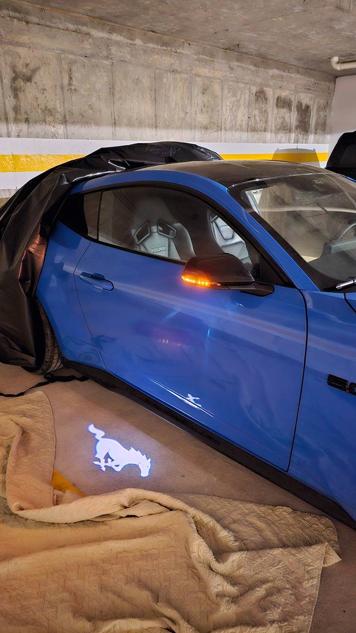

The only thing I'm doubting is the orange light. It looks like some orange bulbs are not working or is this just the design?
In the picture you can see the orange lights are cut out. Is this normal?
If not, I don't care anyways. These lights will pass the inspection and thats the reason why I started this whole headache.

100% normal. not sure why Ford has that gap in the lights, but from memory its intentional
That's good to know.
If @Form Lighting comes with their own style turn signals, that's the first thing I will change, cause they look broken 🤣
