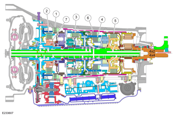

my personal experience, the 10R80 from 2018 to around 2020 was the worst years, i've seen a few vehicles from that timeframe come in with more or less the same issues (harsh shifting, delayed shifting, etc), but it's definitely been getting better. My M1 had a weird thing with it where it hated downshifting to 2nd, as in delayed then harsh shift, but my EB doesnt have that issue so maybe it was a one-off? as with all new technologies, things will not be perfect at first, especially with something as complicated as the 10R80 (it's got 6 shift solenoids and clutch packs with 4 planetary gear sets)
S650 Mustang Automatic Transmission Issues? 1685204633230
when it works, though, it works very, very well, as it can keep you in that power band for high performance driving, but can also give you some pretty good fuel economy
side note: if you hear a whining noise from the transmission, kinda like a supercharger whine, that's normal. it's the straight cut trans fluid pump gears making that noise.
