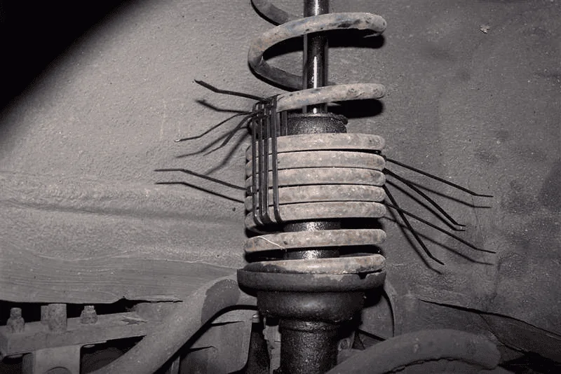

When cutting one has to make sure the location of the endings remain the same, so you have always to cut a complete winding.
Should the endings be flattened, better forget it altogether.
Furthermore, requirement #1:
When the wheel has its maximum travel position and the spring the max. relaxation, the spring needs still have enough compression/pretension not to simply fall off (relates to the rear spring only where it sits relatively free between the whishbone and the frame or however that part of the chassis is called).
Another option btw. is shortening by compression and heat treatment as it is being done also in motorsport.
I would however rather take the professional route of buying springs available.
Even if they are actually produced/fine tuned by the same means, they should provide some official warranty.
