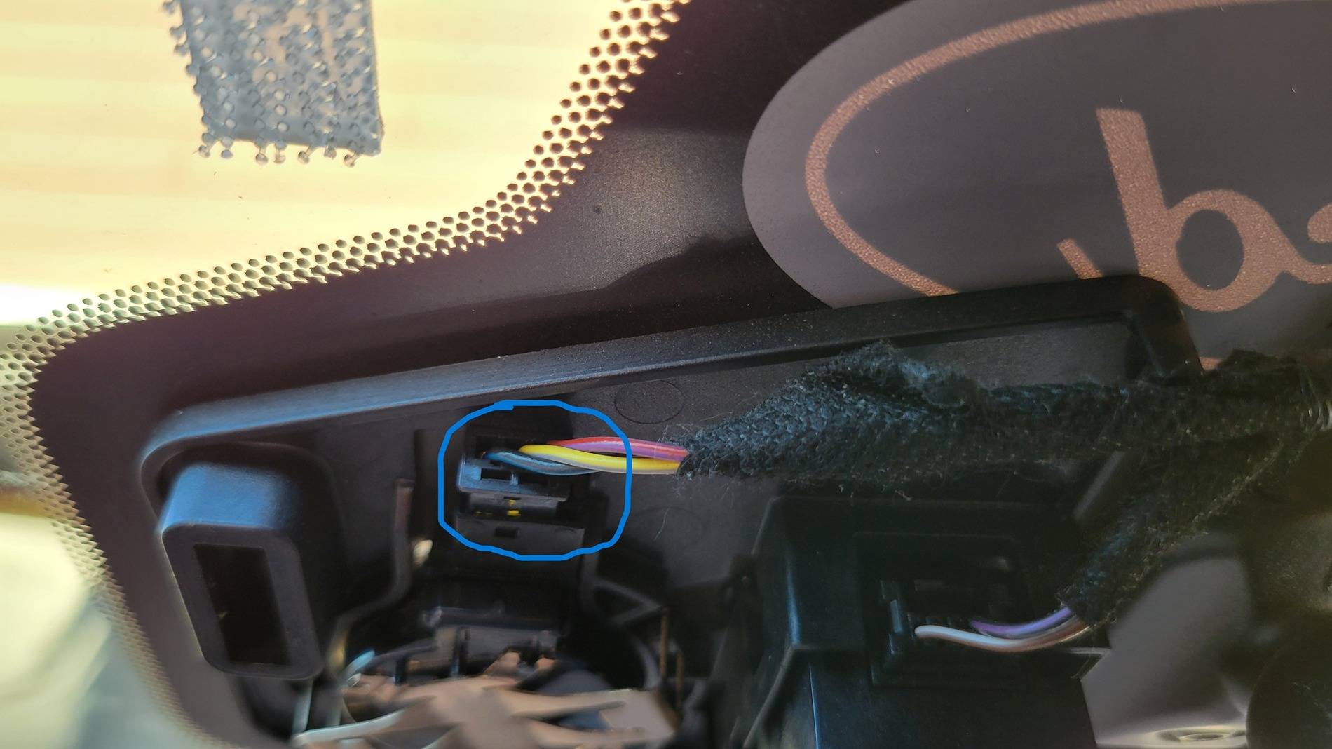

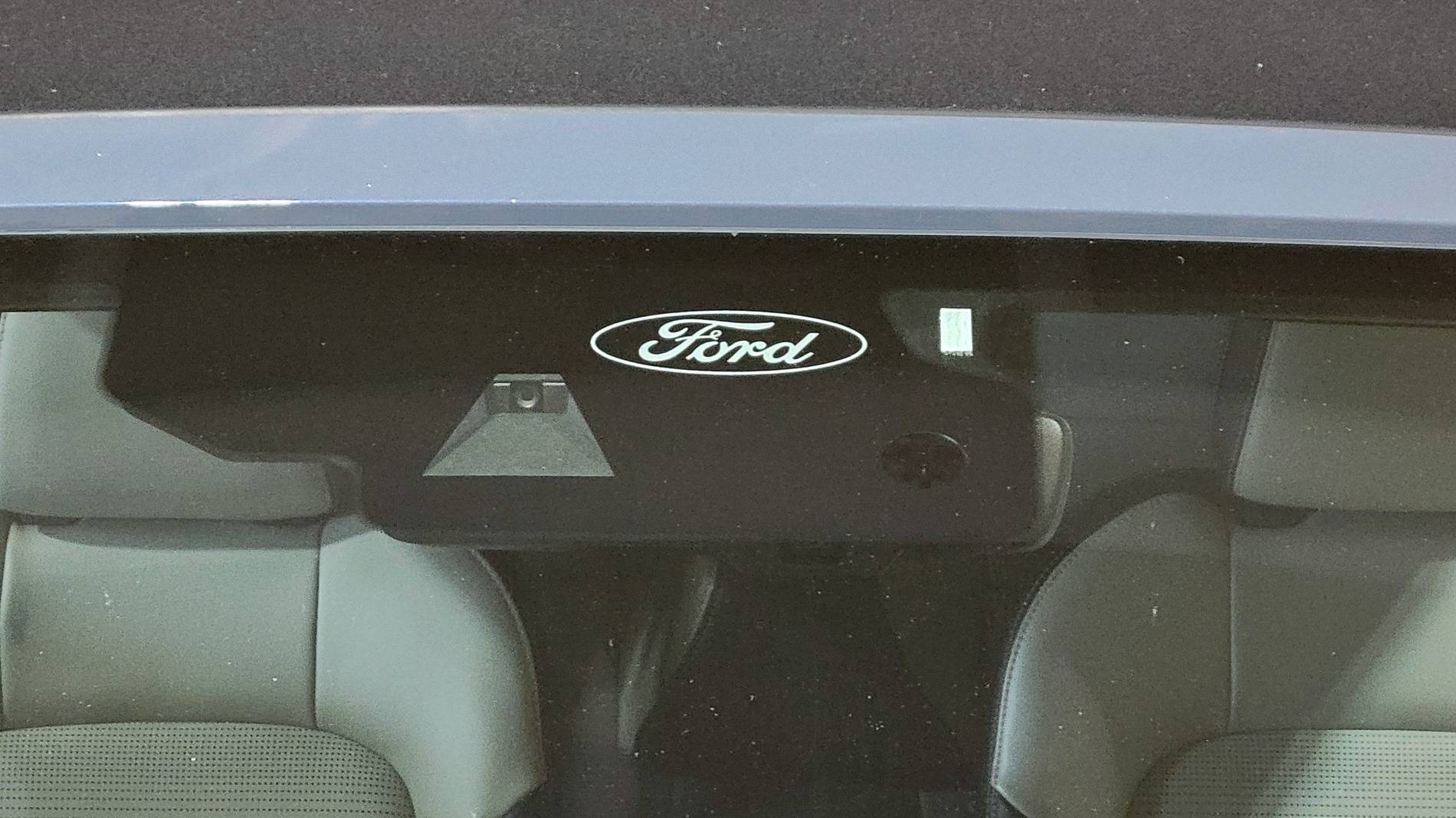

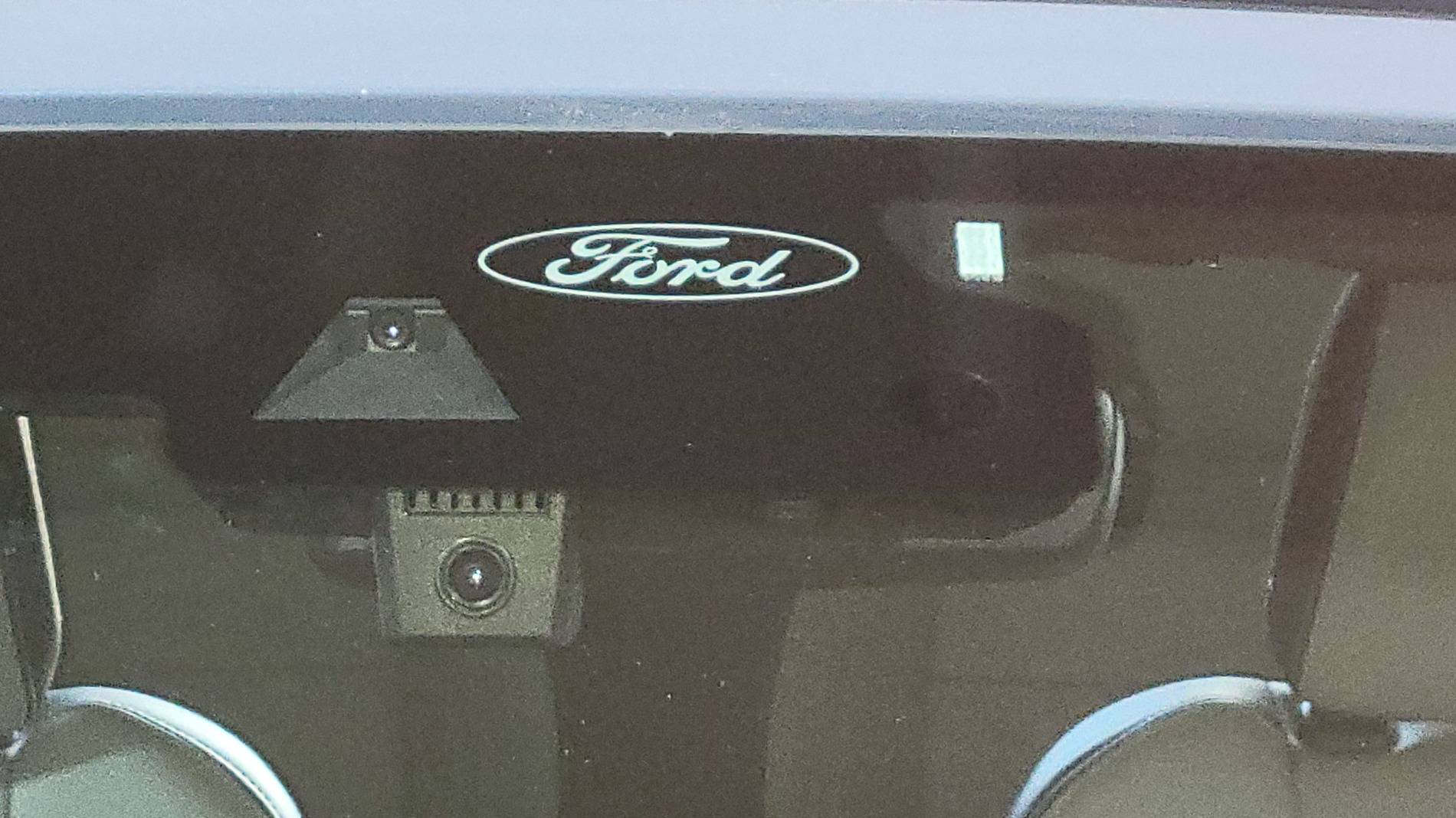

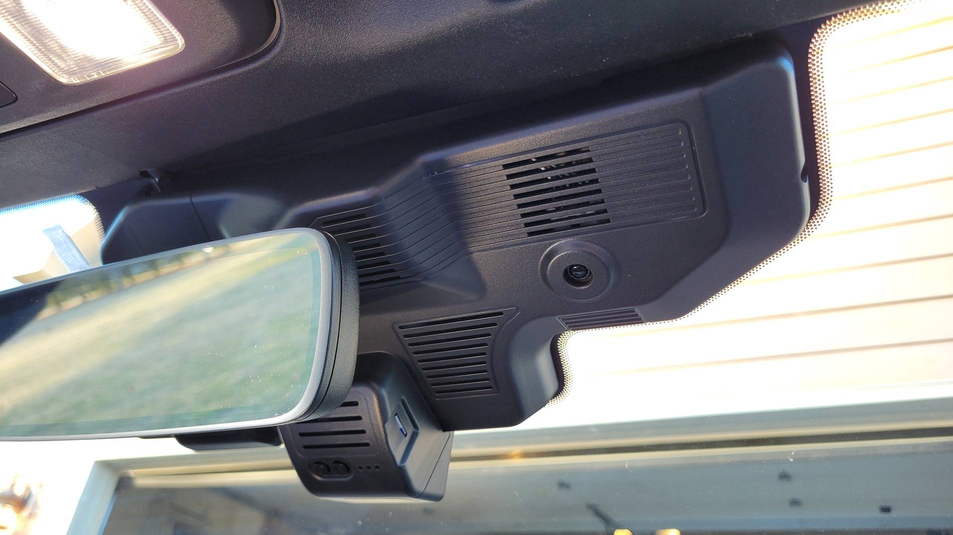

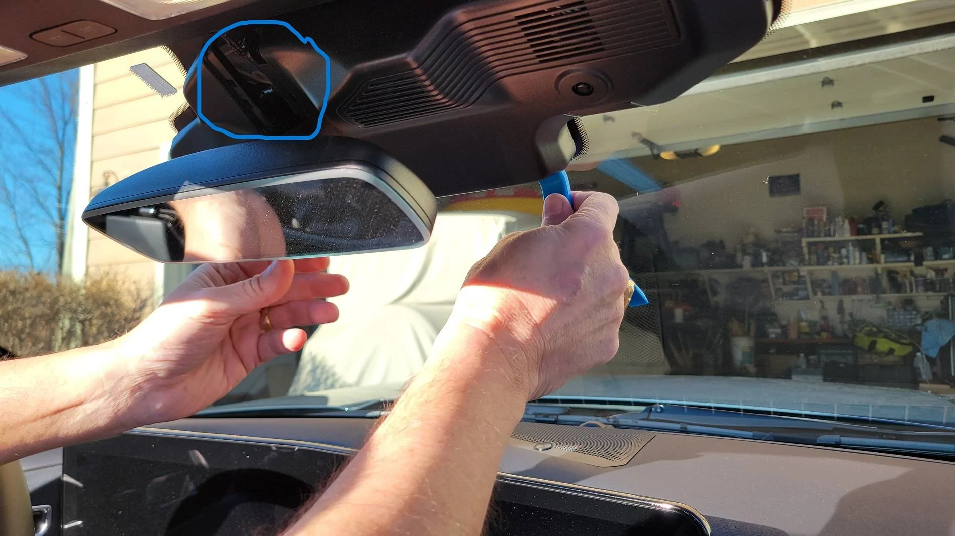

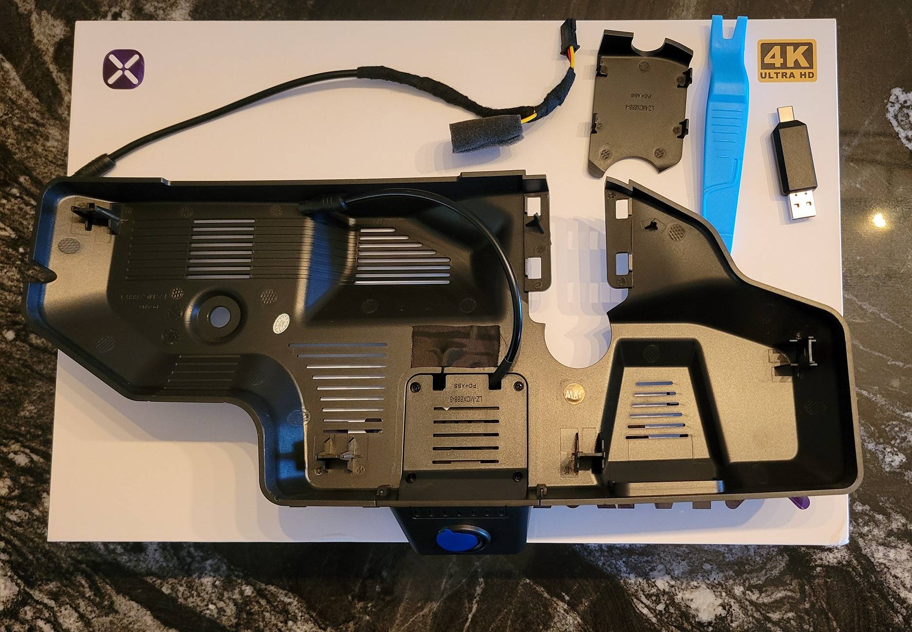

Received and installed my Fitcamx today. Install took about 30-40 mins with most of my time consumed with one clip (top passenger side) that didn't want to come off and then didn't want to snap back on. The other thing that consumed a bit of time was trying to figure out how/where to run the cables without crimping anything to badly. Newly installed cover/camera looks good, integrated into the top plate as if it were OEM which is what I was going for. I already have a Fitcamx on my F-150 so I knew that I was happy with the app & camera's picture quality.
I didn't get a good video of the install, so here are a few before, during, & after pics that I snapped. I marked in blue on a few pictures the couple of key pieces of information. The first is to take the small mirror post piece off first, I used a small flathead screwdriver to pop this off. The second is where the Rain Sensor connection is (Driver's side) as the install video they provide is for a Mach-E and its on the opposite (passenger) side. There were also about 4 other connections up under there presumably depending on your tech package. I also used the un-installed new cover to determine where to pry for the clips with the clip tool and then the un-installed old cover for where to apply pressure when re-installing.
