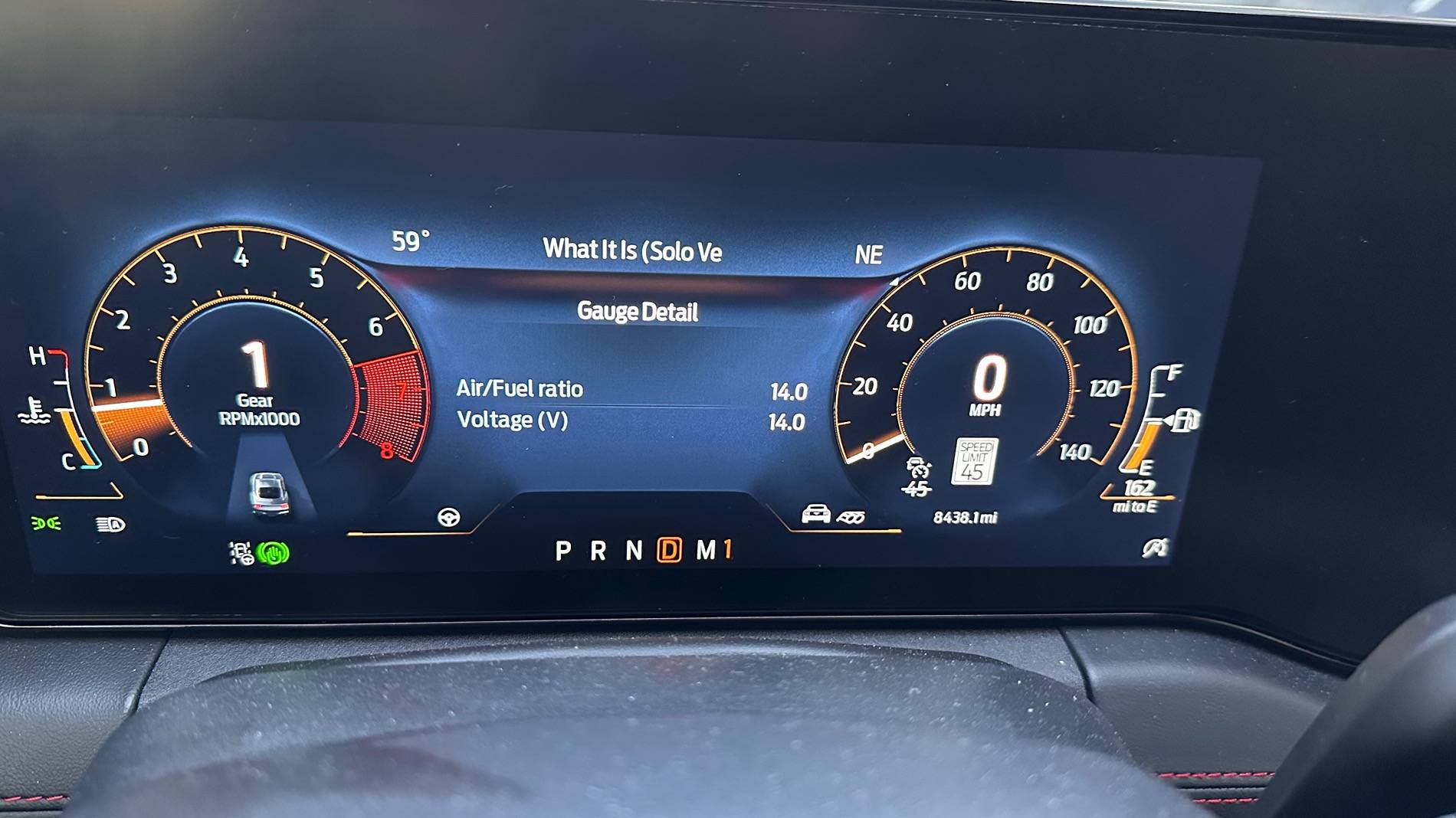

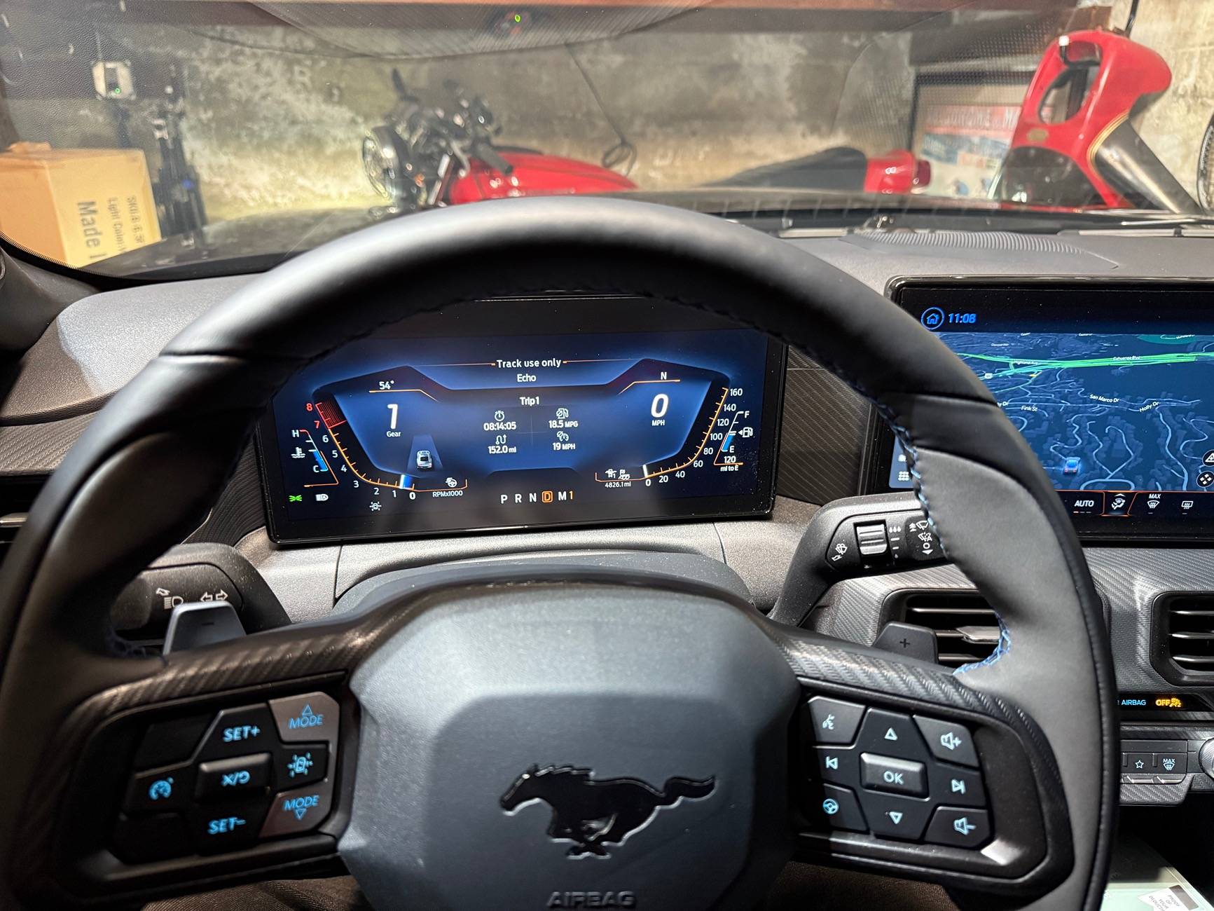

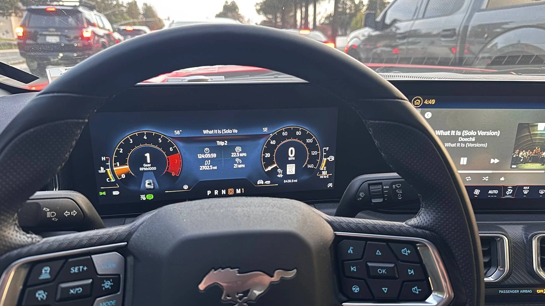

Here's a photo of how my instrument cluster is now, and where the gears are displayed. Small gear icon next to the "M" icon at the bottom, as well as a larger gear icon on the left opposite the speedometer. Both numbers display when the car is in "D" or "M."
Here are all of the steps that I took to get a 101A non-HPP EcoBoost to work with paddle shifters.
- Install new steering wheel (I went with Dark Horse for the black trim, but any GT wheel with paddles should work). Wiring harnesses are the same with the exception of the heated steering wheel option, which was not available on my car. There are a few YouTube videos on this for step-by-step instructions if you need it.
- Enable Select Shift in FORScan (PCM 7E0-03-01 xxxx xxxx x*--) change 1 to a 2. This will make the "L" selection on your gear shifter behave like "M" should but will not change it on your instrument cluster
- Enable Gear Select SST in FORScan (IPC 720-02-01 *xxx xxxx xx--) change 0 to a 4. This is what changed the "L" on my instrument cluster to "M" to actually show gears.
- Enable Continuous Gear Display in FORScan (IPC 720-12-01 xx*x xxxx xx--) change C to E or just use "easy mode" for this swap.
And that's it. Made a few other changes while I had FORScan connected and will likely continue to tweak things as I dig a little deeper into Livnitup's spreadsheet, but that's all that was required to get paddle shifters working which was one of the main features I was missing from my S550.

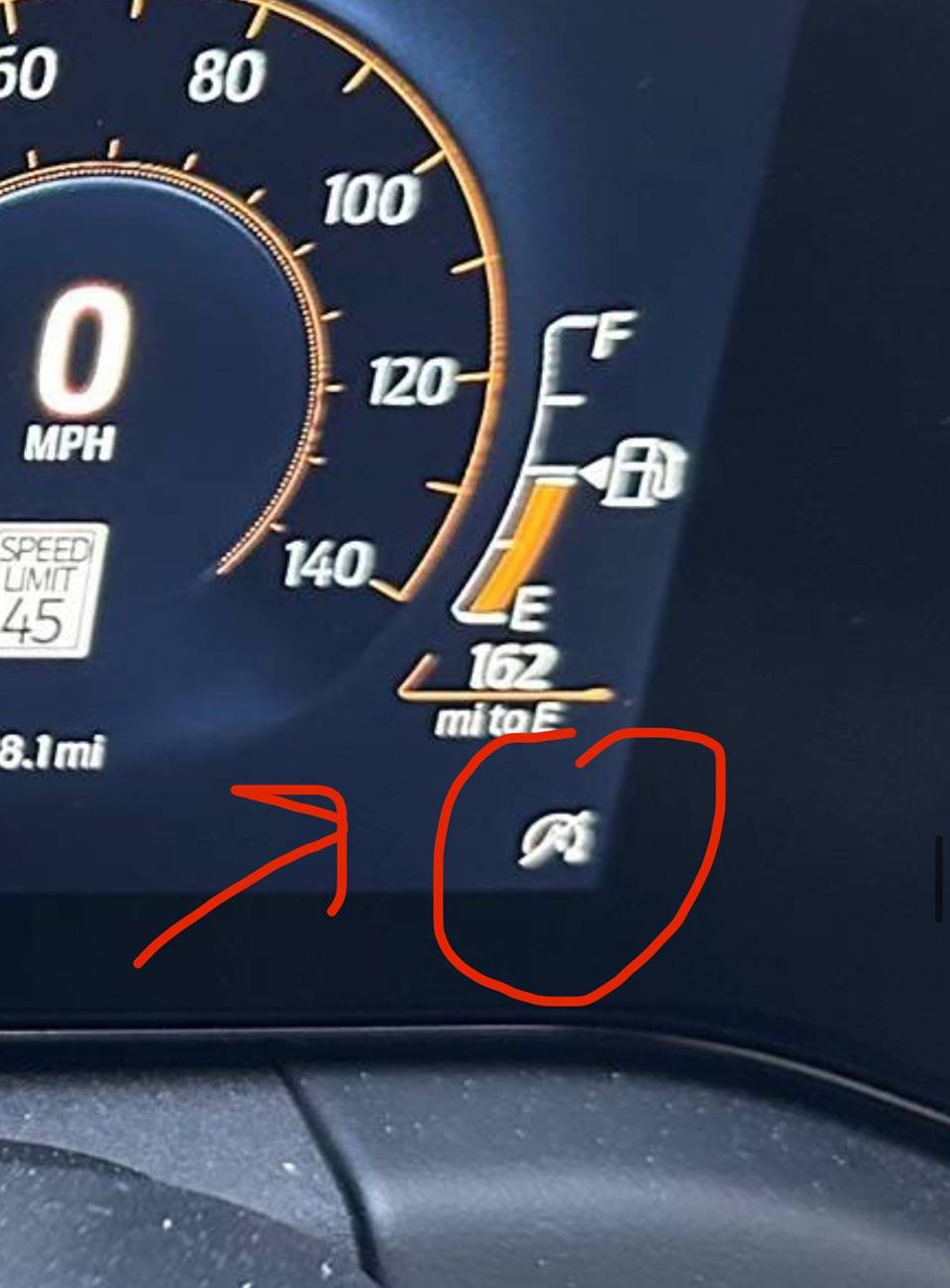

Though gears were not displaying on mine, then enabled this
now gears are displayed but my automatic start stop does not work, it shows this symbol on the bottom right
so I tried enabling the third thing
but in forscan it shows something like, “service interrupted” when I try to do IPC write.
what should I do now; any pointers? No DTCs, (there are 1-2 related to imaging module A or something)
But I am not sure why my automatic start stop start stop does not work? And why I am unable to write to IPC.
I also enabled WAL, and WALF and auto lock from the sheet.
