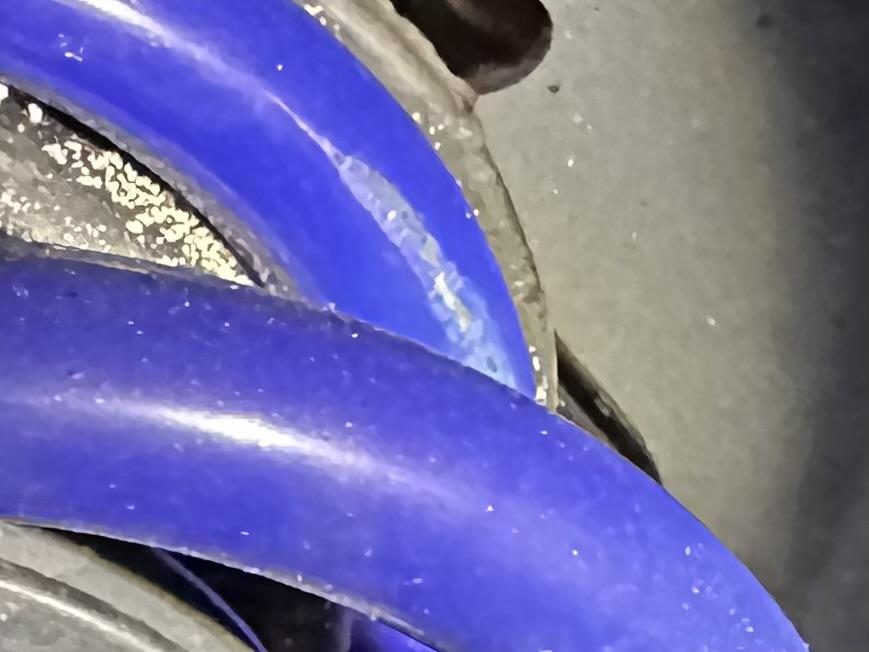

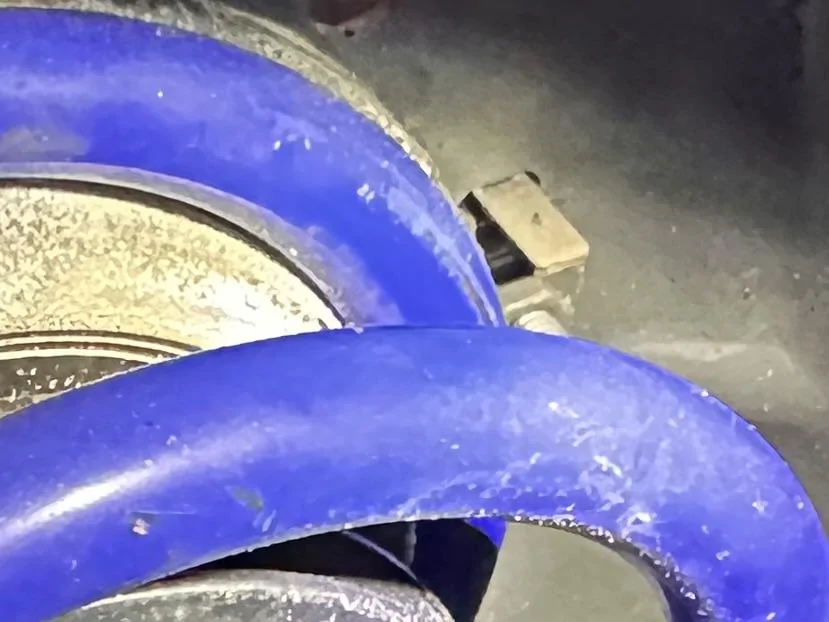

Just to note, @dirtgnome , the marks on your springs are similar to mine.

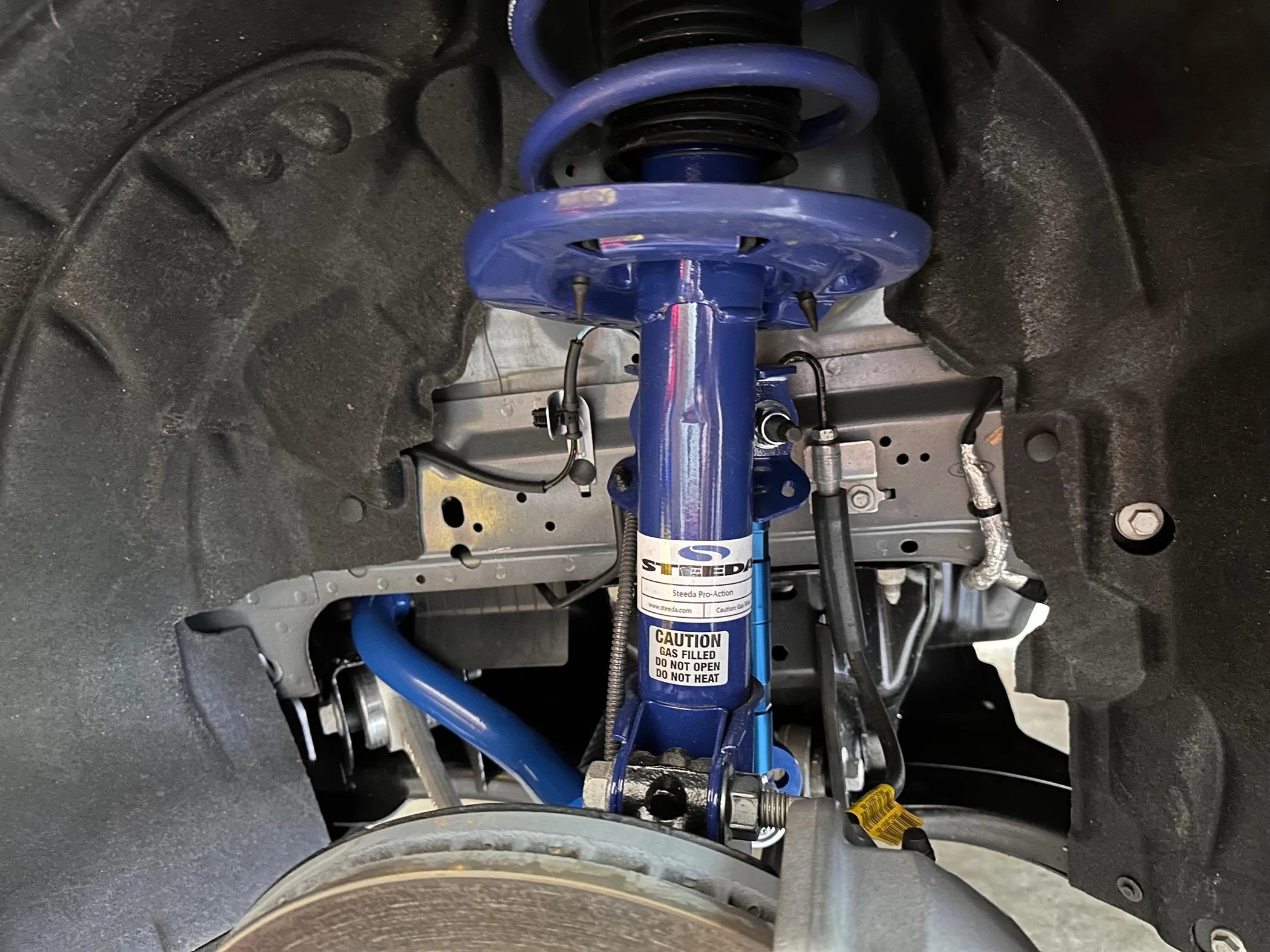

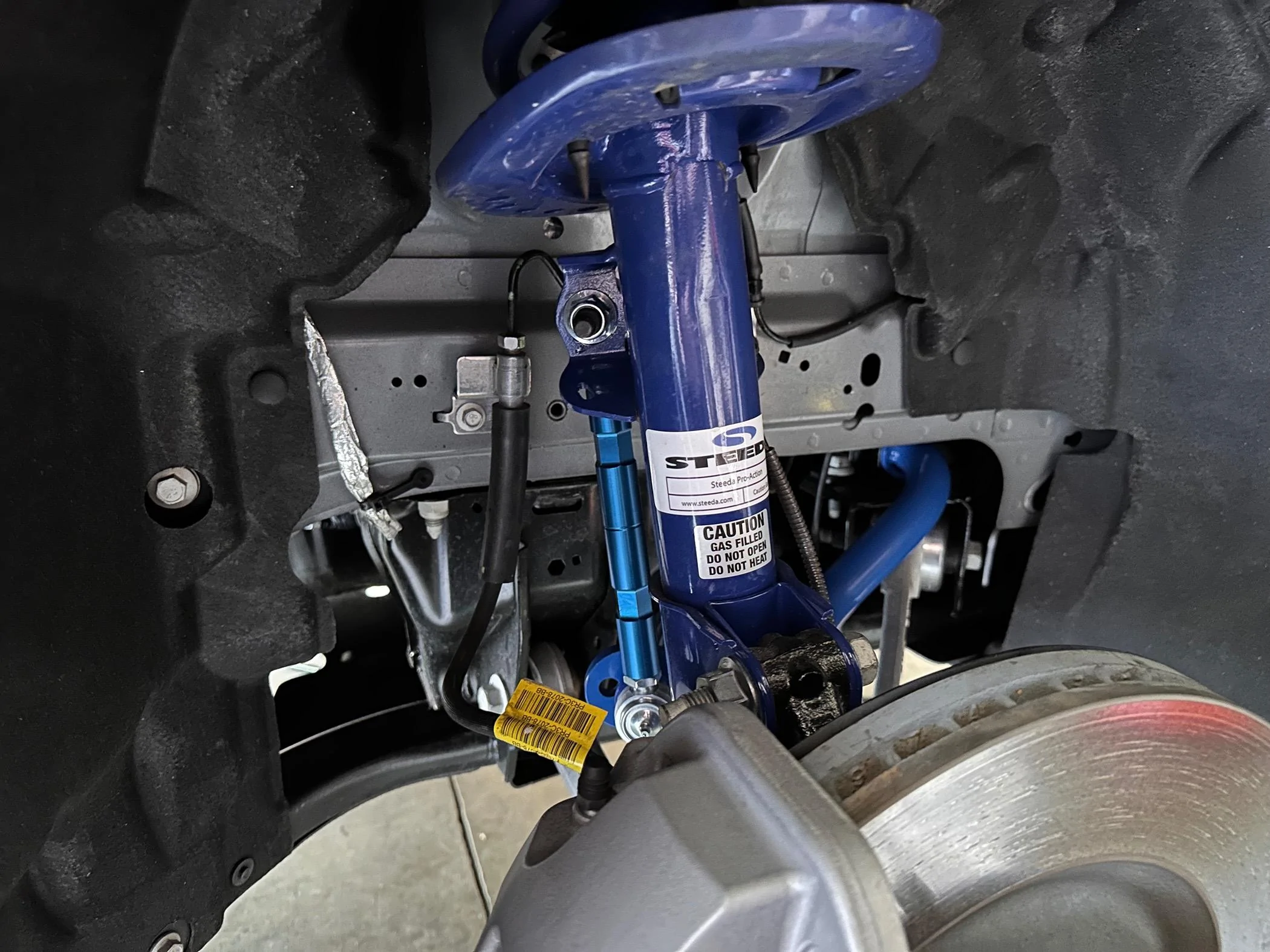

Update on mine….so I replaced the end links today with the Steeda adjustable Endlinks, torqued them to factory specs just like the stock end links. Clunk is gone. For me, it was the stock end links themselves, not the torque as I torqued them multiple times, that were making noise on sharp bumps.

thanks for the update, looks like i might need to buy new end links
I’d definitely put on the sleeve isolators first to make sure that they aren’t your issue. At least before spending the extra money. Ours may not be the same cause.

Those marks are probably from the spring compressors when installing them to the struts.
Most clunks are from the top hats, or the endlinks.
