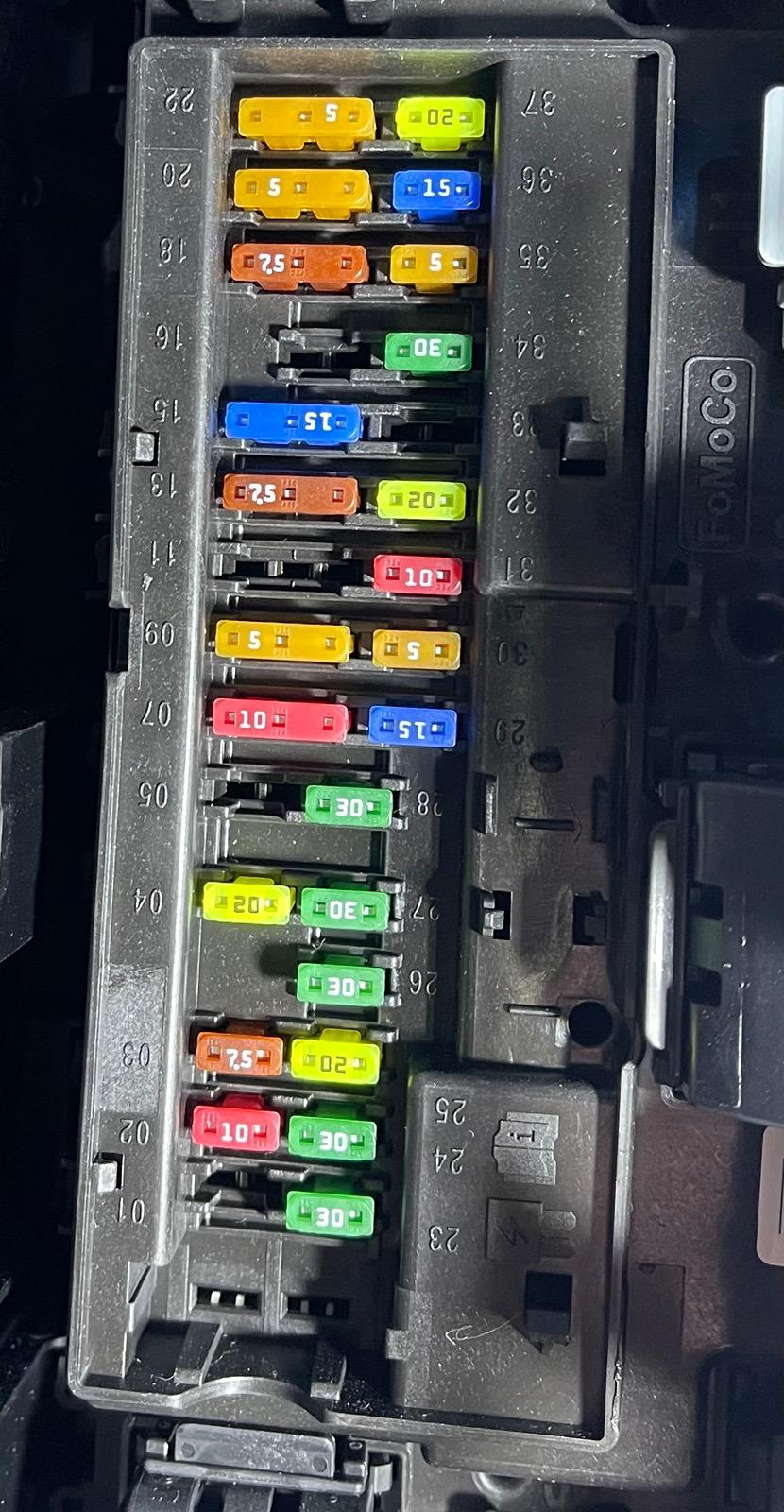

If you go to Page 292 in the 2024 Owners Manual, you'll be given a map of the Body Control Module (BCM)-A unit fuse panel. Fuse #8 is in-line with powering the car's Telematics Control Unit. Removing that fuse will disable the systems and software of concern, without affecting the drivability of the car.
If you use the Ford Pass App, you will lose functionality with that app. Ford Pass uses Telematics to talk to the car and retrieve information.
https://www.fordpro.com/en-us/telematics/
The system, software and feature has been part of Ford and other manufacturers for years.
Edit: anyone "racing" doing autocross or anything like that, pull the fuse before going out. :bandit:
Only issue is that it is a MICRO3 shared fuse with #9 which seems to be the parking brake switch and a couple of sensors. However I think you can use a MICRO2 fuse to disable the fuse 8 connection.
Someone would need to test to make sure MICRO2 fits.
1,293
1,820
≈39N
Touch'e.
Attached is a picture of what you're referring to.
On the 550, #9 position is not used, even though it is shared with #8.
So, ya. My bad. A dedicated position #9 fuse would need to be tested.
