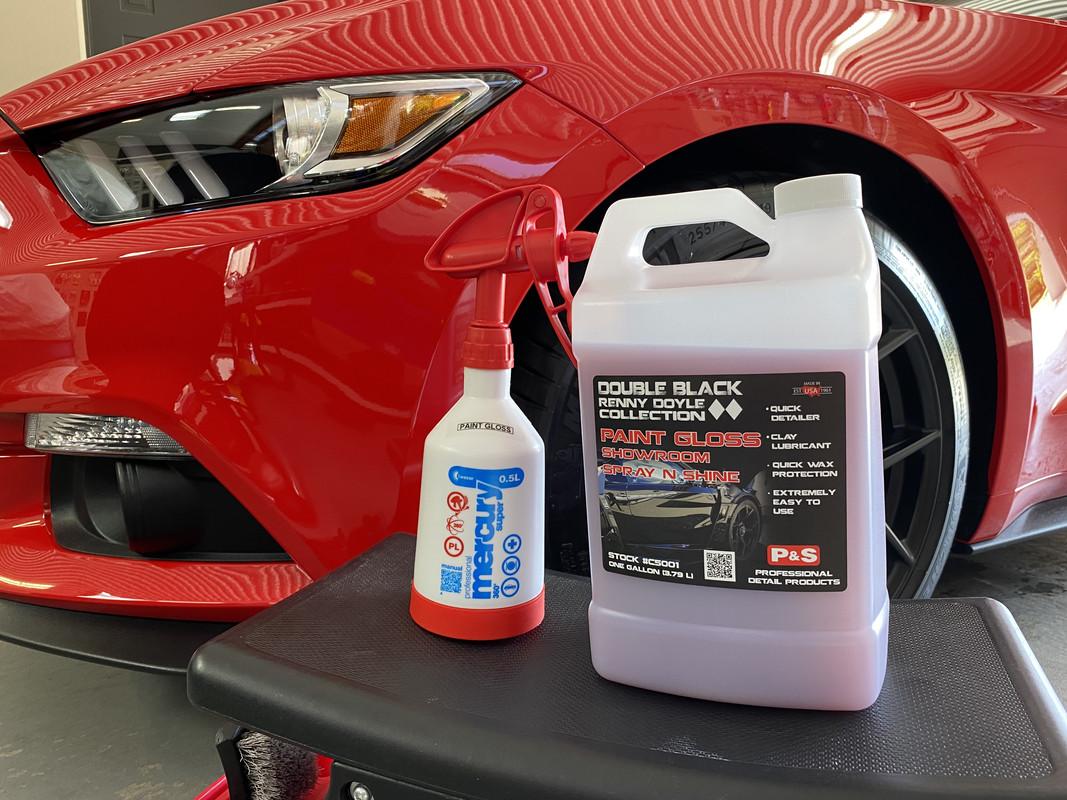

P&S Detail Products - Paint Gloss Showroom Spray N Shine | Rag Company – The Rag Company

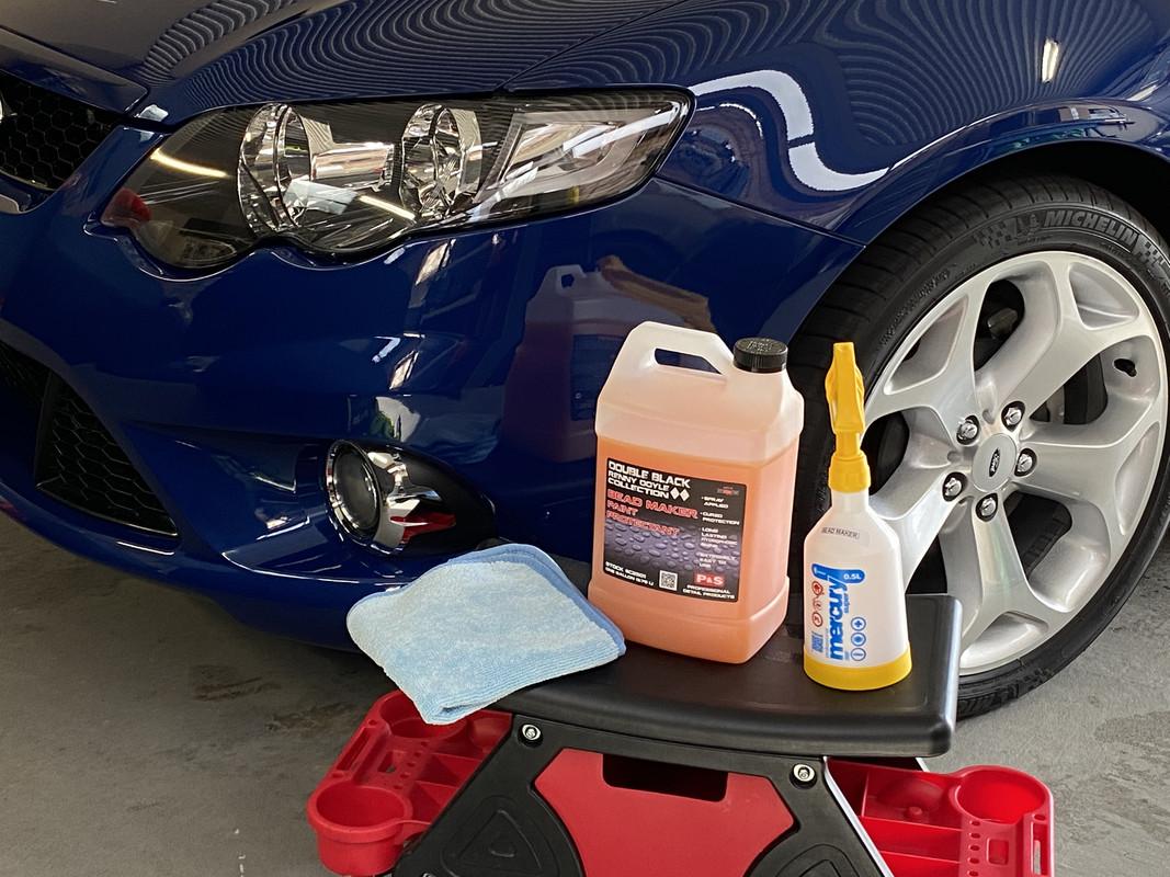

Bead Maker is a love or hate thing. It was certainly over hyped in the beginning, which led people to latch onto its negatives rather than enjoy it for what it is.
Detractors point to the lack of longevity, the lack or water beads (despite the name), problems with streaking, and as you have noted, "attracting" dust.
On the flip side, the gloss and slickness it provides is stunning, and for me at least, its very easy to work with.
For me, I don't care how long it lasts, mainly because you end up reapplying after each wash as a drying aid. The water beading, its fine. The dusting, it is a thing in dry climates and more noticeable on darker colors. To be fair, Bead Maker doesn't necessarily "attract" dust, rather it creates a static charge on the paint which "retains" dust. Bead Maker is not alone in doing this, but its the one most people know of because of how popular it became.
But.......................... very few spray and wipe products can match the gloss and slickness Bead Maker brings to the table.
If the dust thing is of high concern, then I would suggest looking at Paint Gloss, this has natural anti-static properties, while approaching near Bead Maker levels of gloss and slickness. The OG Drying Aid I also linked doesn't seem to retain dust either.

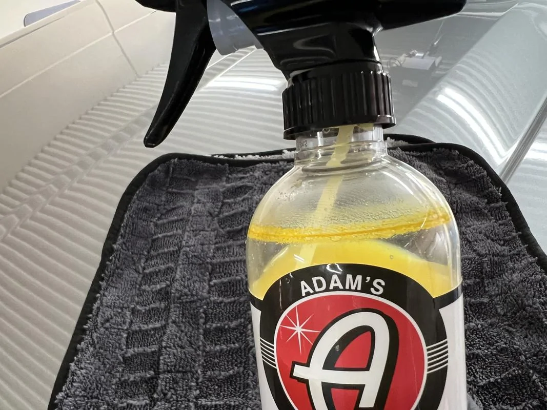

The Obsessed Garage Drying Aid is not groundbreaking, but it works very well with minimal complication. The product itself is a catalog item called 'Slipstream' and is produced by a large chemical blending company, as such it has many different variations and is sold under different brands. Of the ones that I know of, Adams, Ethos and Xtreme Solutions all have their versions of the Slipstream.

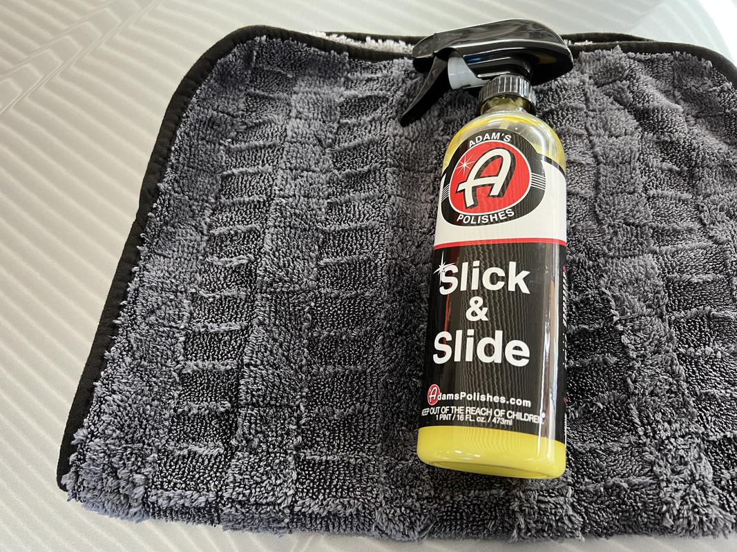

Adam's Slick n Slide - this version is colored yellow and heavily scented with a tropical aroma.
Adam's Slick & Slide - Adam's Polishes (adamspolishes.com)

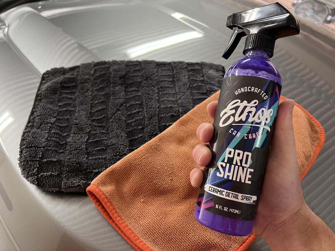

Ethos Pro Shine - again, heavily colored and scented. Both this and the Adams I have found to be less stable, the colorant stains the bottle and overall, these two need some additional wipes to level down.
Ceramic Detail Spray - Quick Detailer, Streak Free Formula! (ethoscarcare.com)

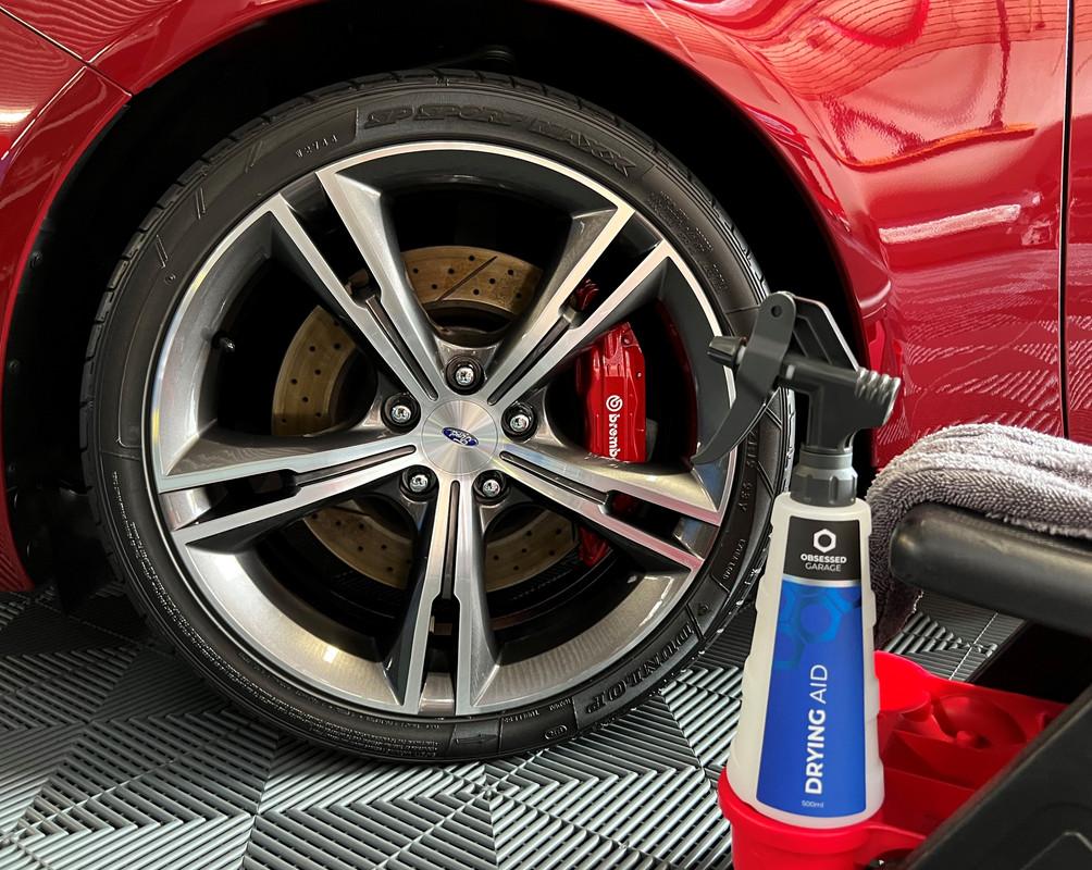

Obsessed Garage Drying Aid - the story here is that they wanted to sell Xtreme Solutions Topper to replace Bead Maker in the store. After being given the runaround and lied to about where and who was making the product, OG went and developed their own version of Slipstream. In this case, they removed the colorant and scent to improve stability and application. Sure, the lack of scent removes some of the wow factory, but in practice, the product is easier to use.
Drying Aid | Car Paint Protectant | Obsessed Garage

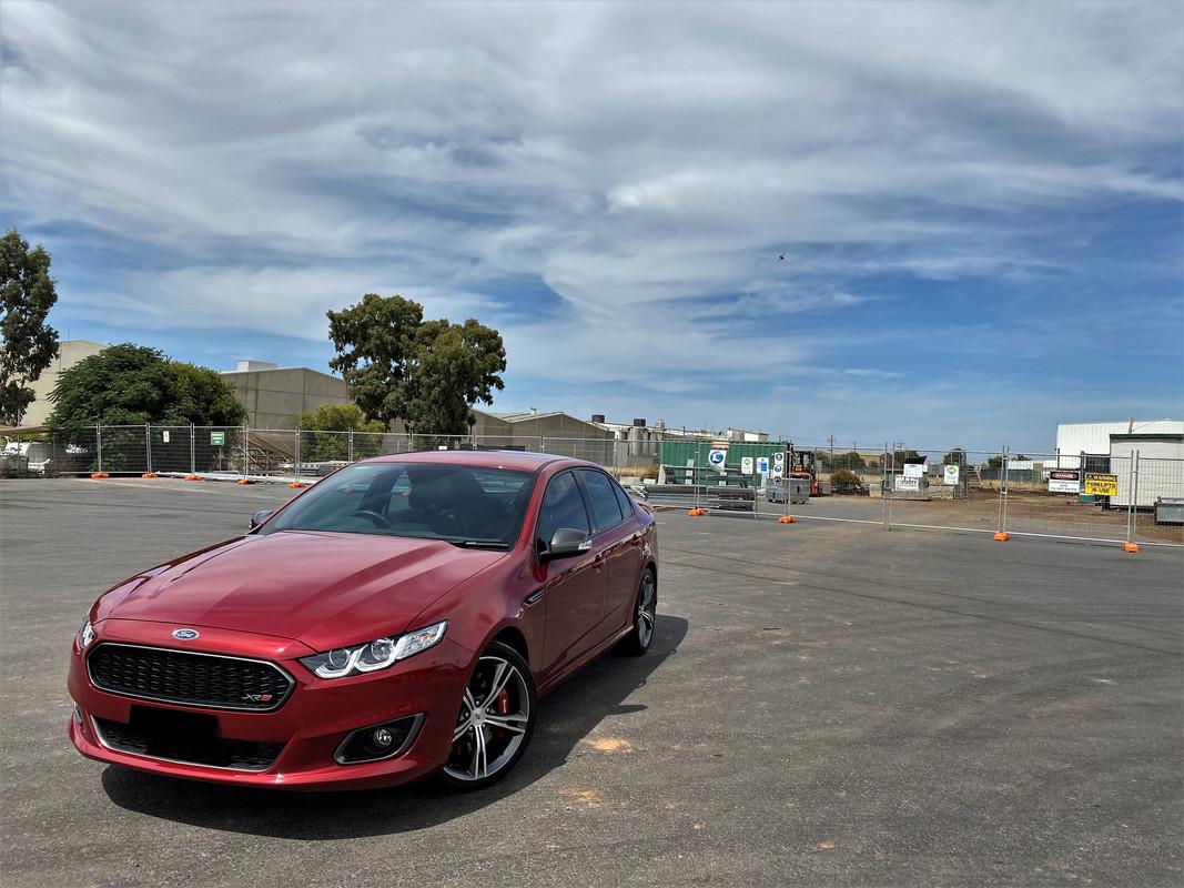

(Can you name the car below?)

I just noticed the question you asked. The only thing I can tell is the Ford on the center cap. I’ll guess Mustang or Fusion?

No to the first guess, no to the second but getting closer.

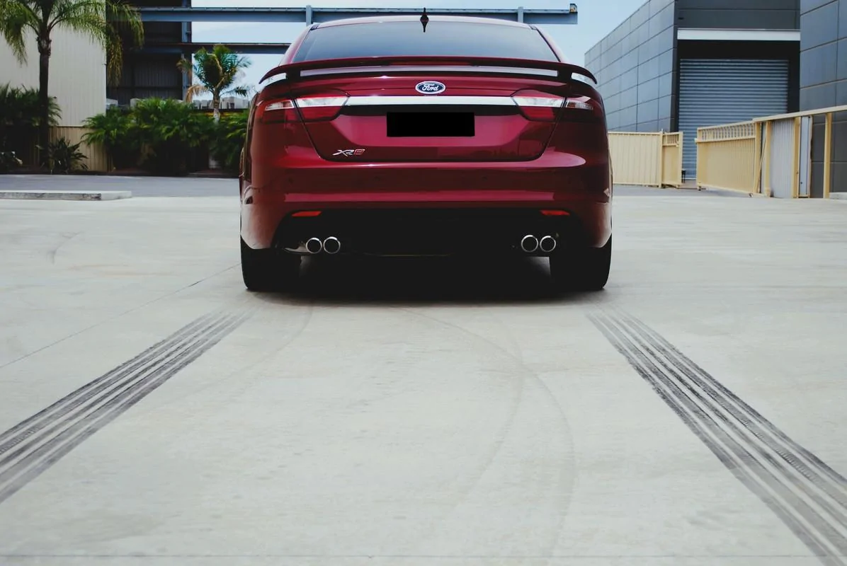

This is my beloved FG-X Falcon XR8. When Ford announced the closure of their Australian factories, I knew I had to have one of the last Falcon's. The car will be 10 years old this November and has only done about 7000 km (4400 miles), I only drive when the mood takes me there, its never been driven in the rain either.
These Falcon's are far removed from a Mustang, the Mustang connection was broken way back in the early 70's, but it does have a Mustang influenced heart.
S650 Mustang Opinions or knowledge of PPF and Ceramic Coatings fgxm101
S650 Mustang Opinions or knowledge of PPF and Ceramic Coatings fgxm104

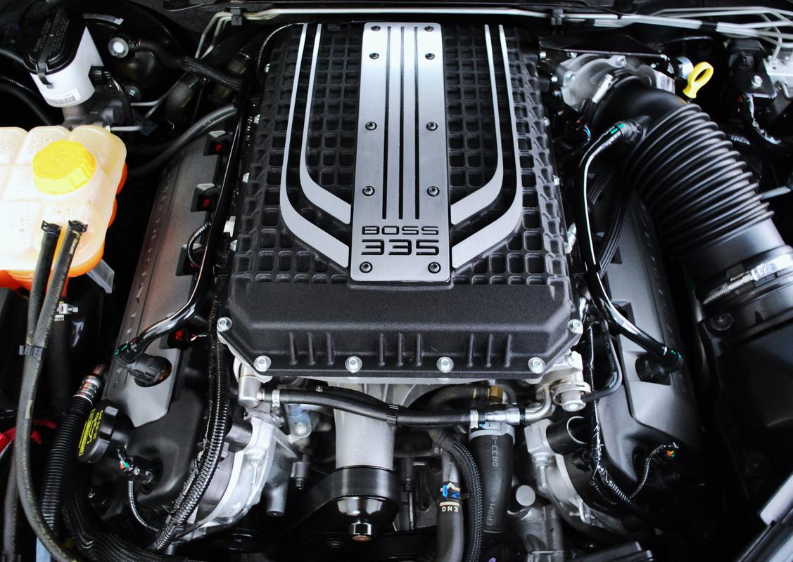

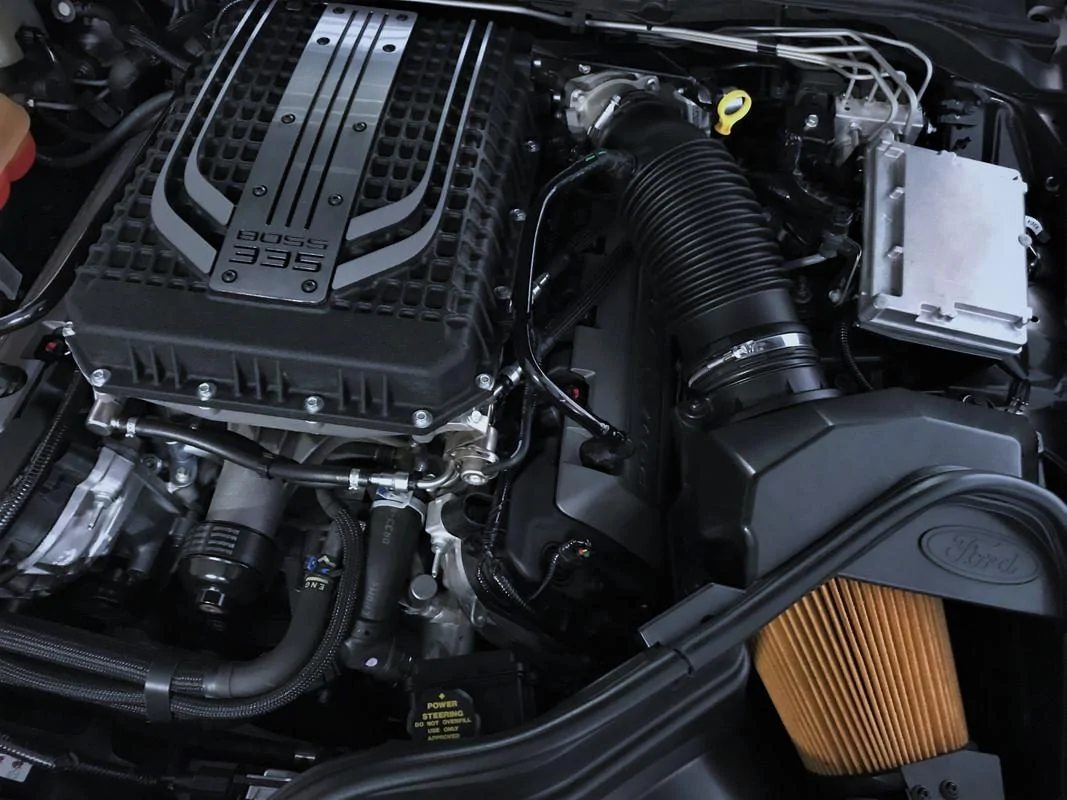

You will notice some familiarity to the way the engine looks, but these versions of the Coyote were locally manufactured from imported blocks and heads. Devolved in Australia, the engine featured a supercharger and various other Australian spec parts. The result was the first factory supercharged Coyote 5.0 in the world, debuting way back in 2010. Each engine was hand built and signed by the man responsible for it.
Power and torque varied depending on the model it was used in, mine has the Boss 335 version with 335 kW or 450 hp. Those numbers were least it would produce, they could over-boost up to 500 hp in the right conditions, some models could go out to above 420 kw or 563 hp. All for $60,000 AUD.

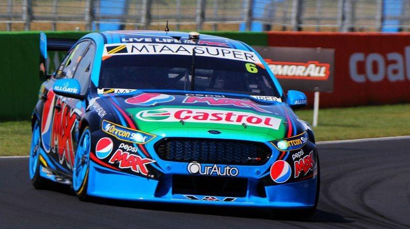

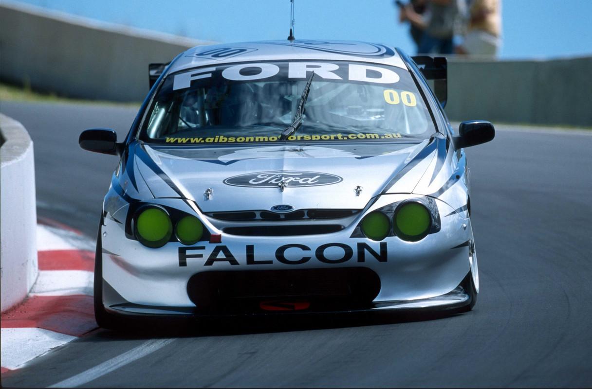

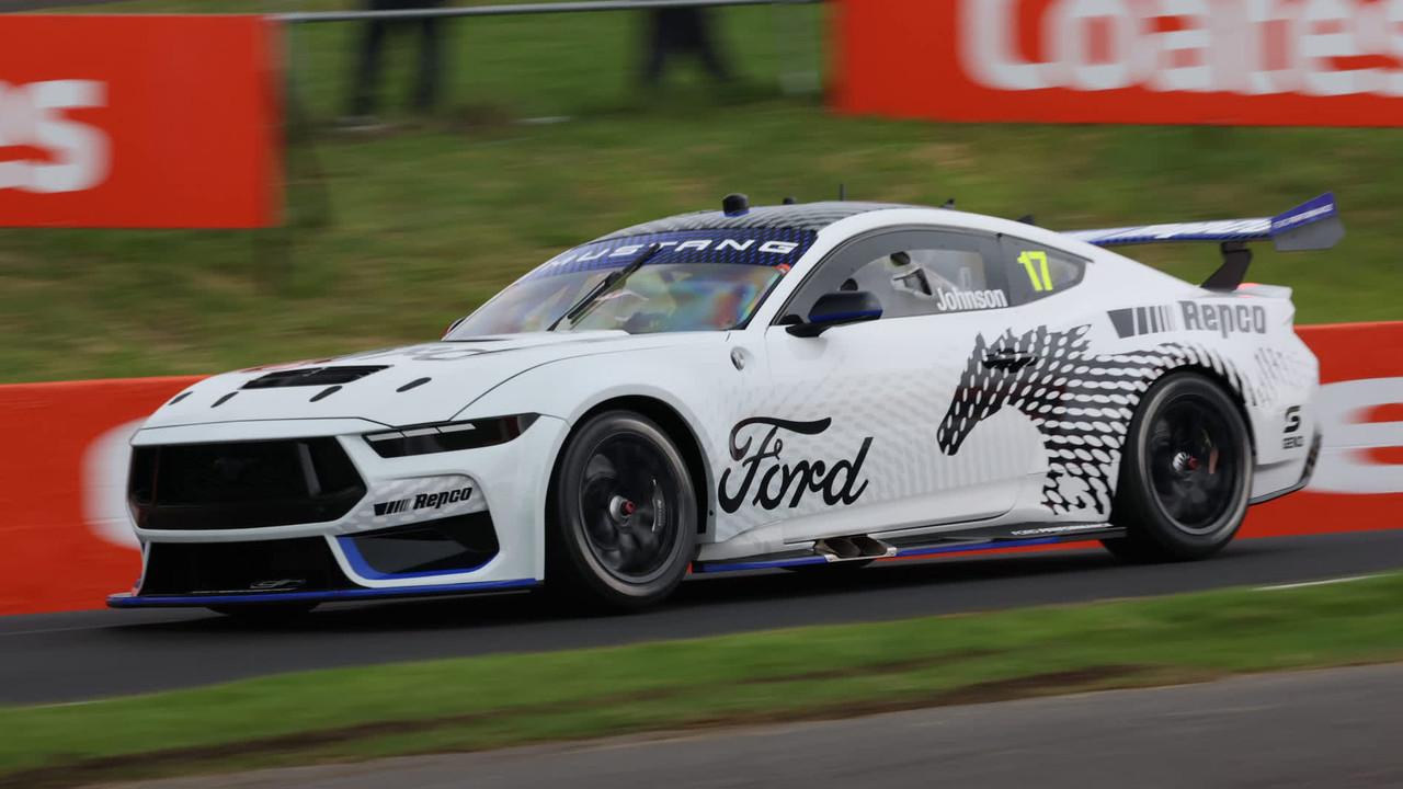

Aren't / weren't a large number of "Falcons' being raced in the V8 Supercars circuit? Now I see more "mustangs" are appearing in the lineup.

Correct. Falcon was in the V8 Supercars for decades but was replaced by the Mustang a few years after the Falcon ceased production. Currently they are running S650's.

Just listen that thing scream, I think every Ford supporter had a man-crush on Scott McLaughlin, who now races Indy Car. If you don't have goosebumps after this lap, there's something wrong with you!

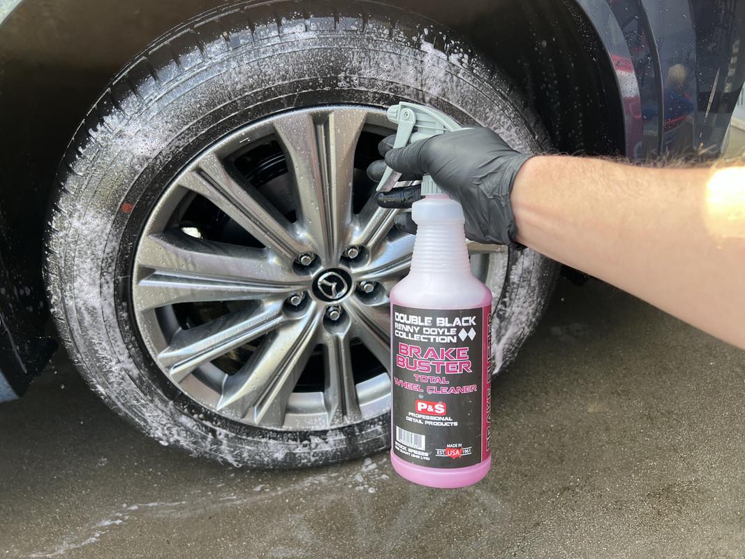

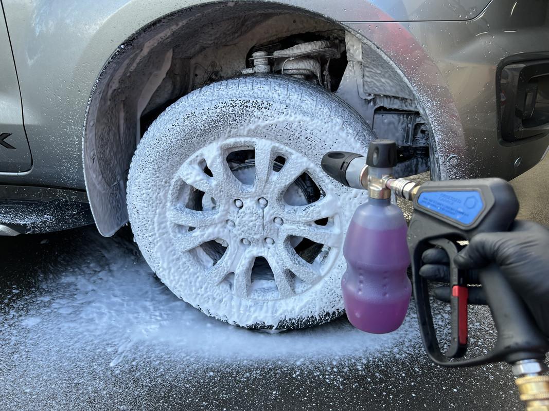

If you feel the need for a wheel cleaner, I've settled on P&S Brake Buster. This can be used undiluted for heavy cleaning or tire scrubbing. If you want to use it regularly, I would dilute it out to 10:1 so it doesn't hammer the coating as much. For wheels, I use it straight in a foam cannon, which does the diluting for me. When foamed, Brake Buster clings to the wheel and allows for a longer working time. This product also contains rust inhibitors, which help reduce the flash rust appearing on the rotors.
P&S Detail Products - Brake Buster Wheel Cleaner | The Rag Company

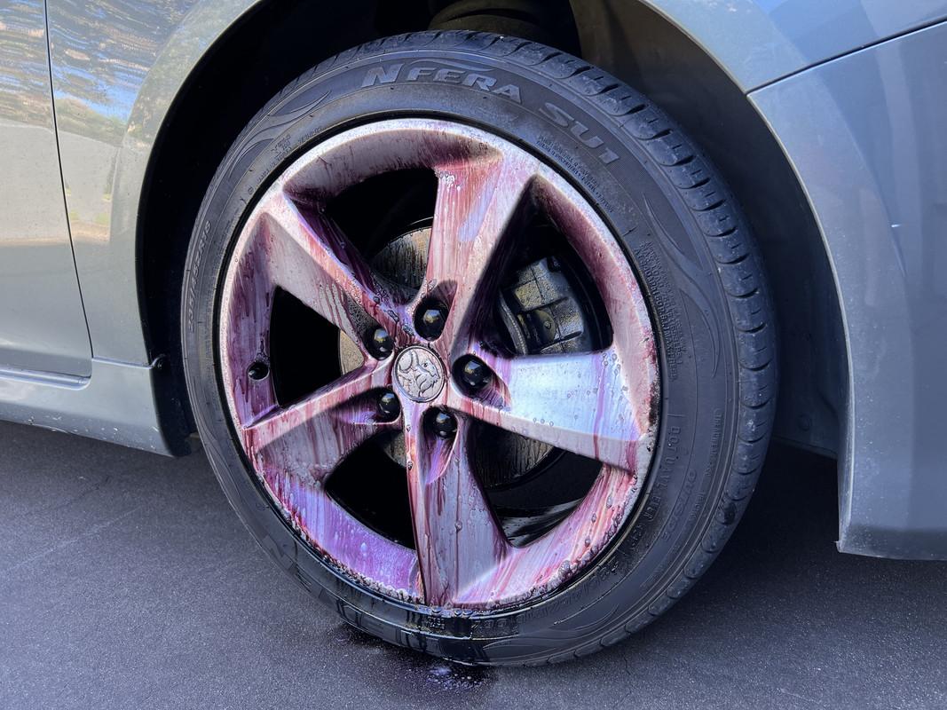

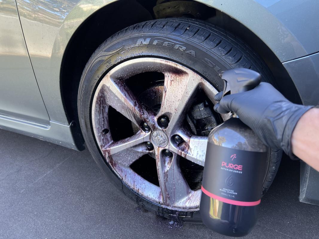

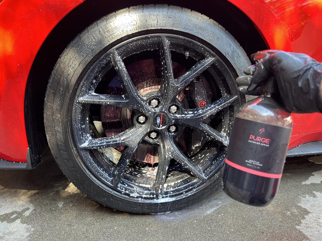

While Brake Buster is a good all-rounder and ideal for regular use when diluted, sometimes you need a little more. I use NV Purge once every few months to provide a deeper clean and dissolve any iron contamination. On well maintained wheels, you may not see a lot of reaction, but they are still worth having. These type of iron remover wheel cleaners are pH neutral, so they won't trash your coating, in fact they can help prolong the lifespan of it. I choose NV Purge because of its performance, but also because it's the least offensive smelling iron removers on the market.
Purge | Reactive Wheel Cleaner – Nv Car Care USA

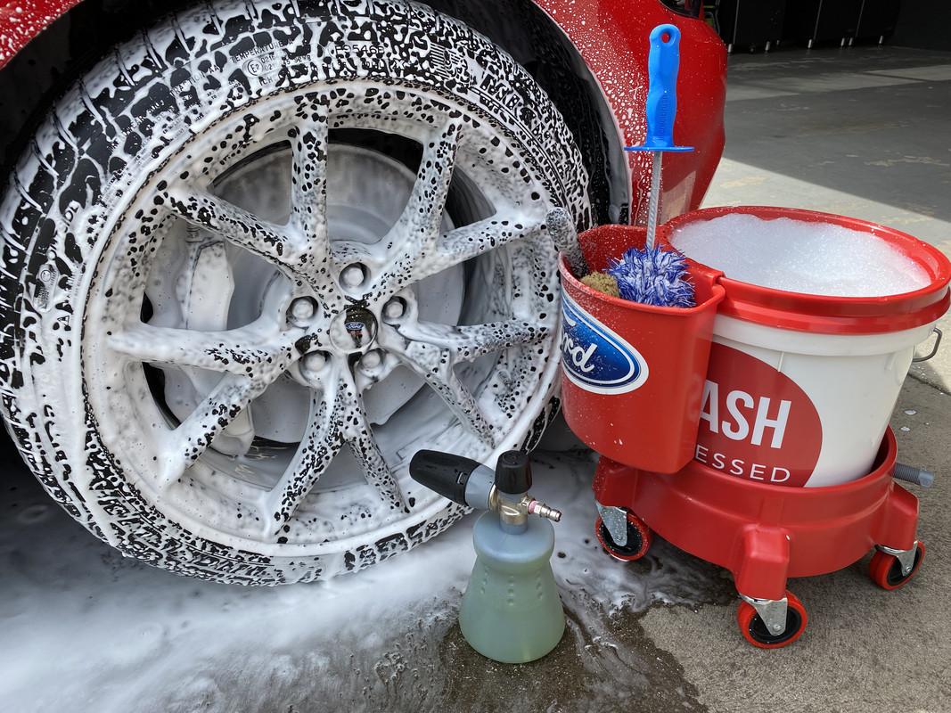

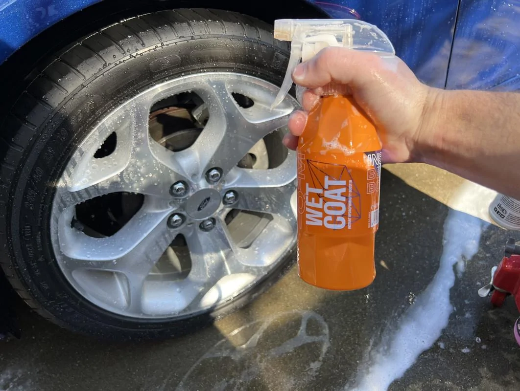

Every 3rd or 4th wash, I also add a spray and rinse product on the wheels to help keep the coating fresh and extend its life. Gyeon Wet Coat or Carpro Hydr02 Lite are what I use.
Gyeon Q2M WetCoat | Car Supplies Warehouse – Car Supplies Warehouse
CARPRO HydrO2 Lite | Car Supplies Warehouse – Car Supplies Warehouse
S650 Mustang Opinions or knowledge of PPF and Ceramic Coatings IMG-3795

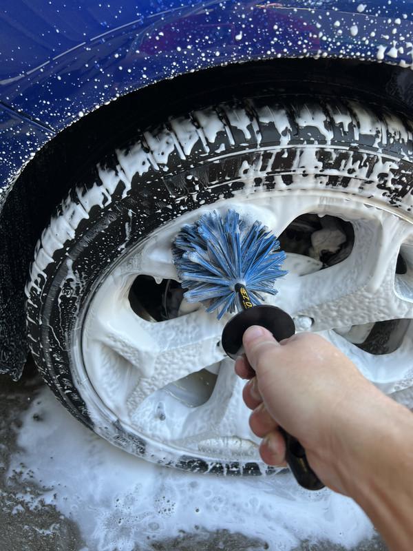

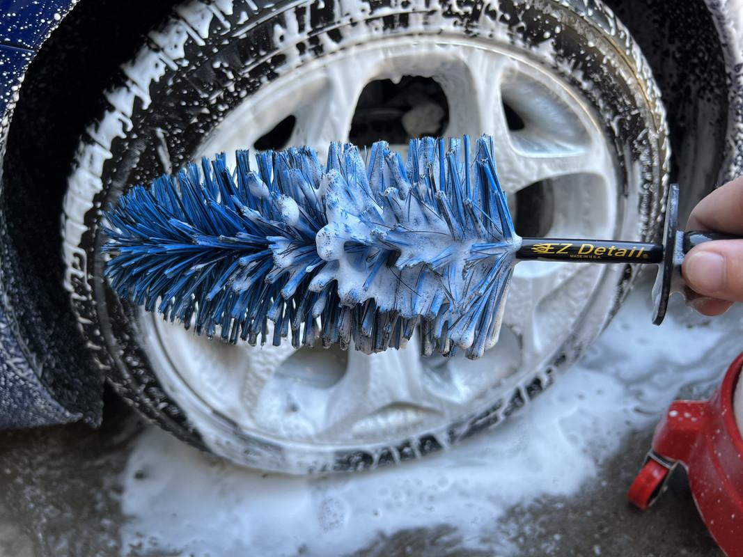

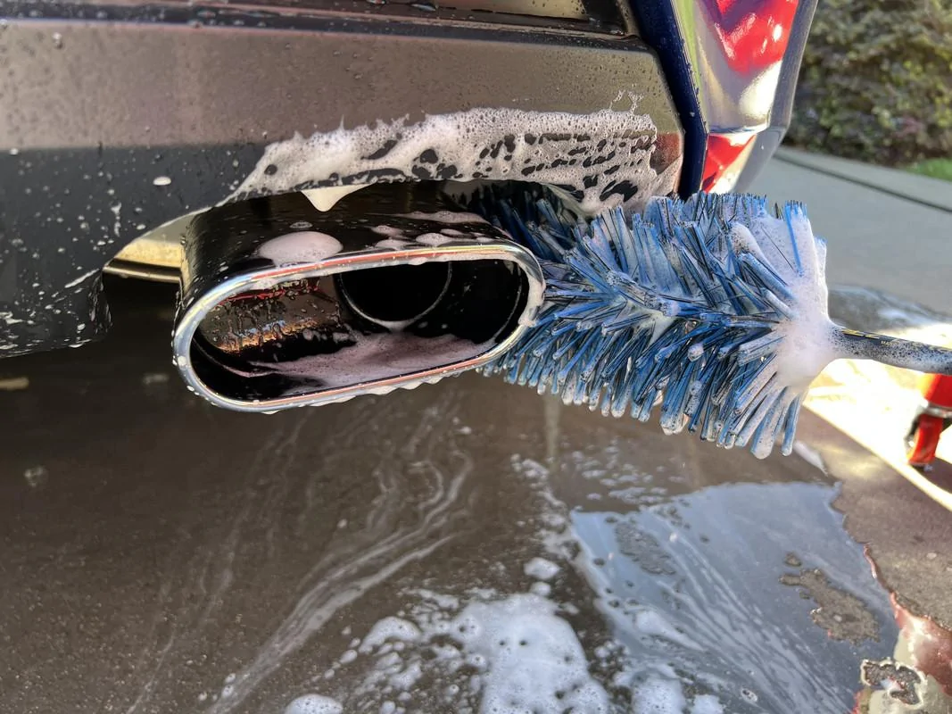

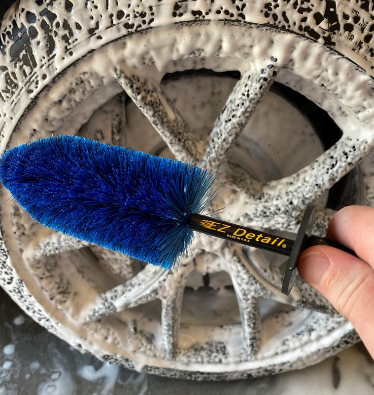

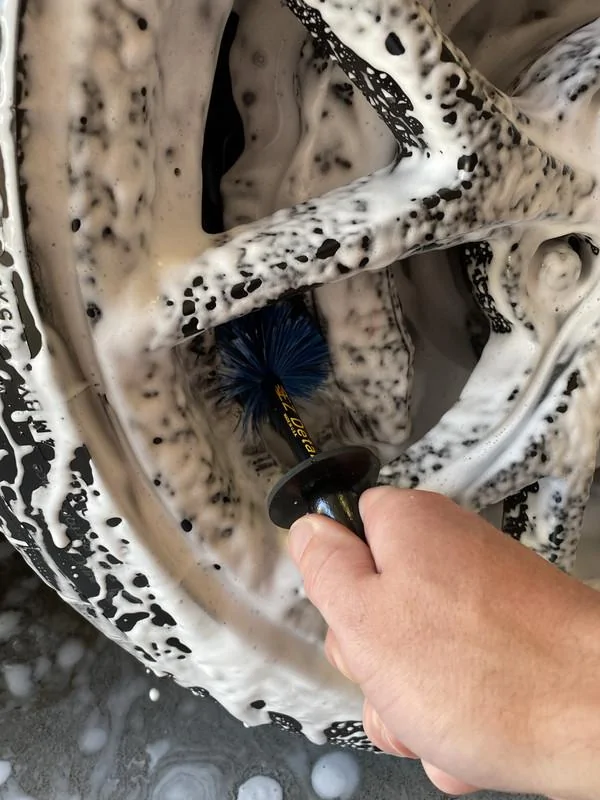

Also, if you have the Brembo brakes (or the PP wheels), you are most likely going to need one of the EZ-Detail brushes to gain access to the barrels. I have both, but if you are picking one, go for the large version. Great for exhaust tips too.
EZ Detail "Big EZ" Wheel Brush | Car Supplies Warehouse – Car Supplies Warehouse
EZ Detail "Little EZ" Wheel Brush | Car Supplies Warehouse – Car Supplies Warehouse

a foam cannon is really not a no touch wash if thats what your thinking.
its more to breakdown stuck on junk and greatly depends on the soap you use run of the mill soap is going to do basically nothing something like car pro descale or bilt hamber touch less will do a good job breaking down stuff.
and no they dont mean no touch it's very deceptive i wish they would change the way we all talk about it they mean touching the car less things like that should be called less touch and no touch to avoid confusion.
any way back on topic
but it can help in with scratching the car less
obsessed garage on youtube has alot of videos you can watch to get a feel for this junk
and
obviously a ceramic coating helps massively with stuff washing off with the foam cannon.
Appreciate the feedback. So in essence its like a Pre-Wash step and as you stated, breaking down stuff that may scratch the car. I've always hosed the car down really good before applying a good car shampoo with a soft microfiber mit. As roadpilot previously mentioned, do not wash in circles/swirls, I go up/down, sideways but never in circles, as we were taught in the 60's.
I suppose I can see the usefulness of the cannon, just not sure its worth the $$ to be a Pre-Wash tool. Will keep investigating.
