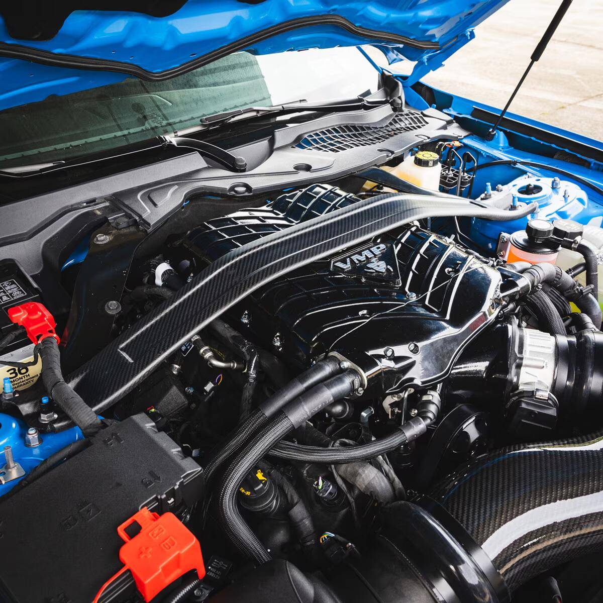

@JimC .....I agree 100% - keeping the strut tower brace is massive and becomes even more important imo the more HP and torque your engine generates. Everyone I know who has added a strut tower brace says they can "feel" the difference. IF I did any engine mod that eliminated the OEM Ford cross engine strut tower brace I would find a way to do a custom welded work around. Yes with the s650 you still have the firewall to individual strut brace pieces but imo the cross tower brace is essential to a healthy and safe front end.
VMP makes a carbon fiber strut tower brace that works with the Whipple supercharger.
