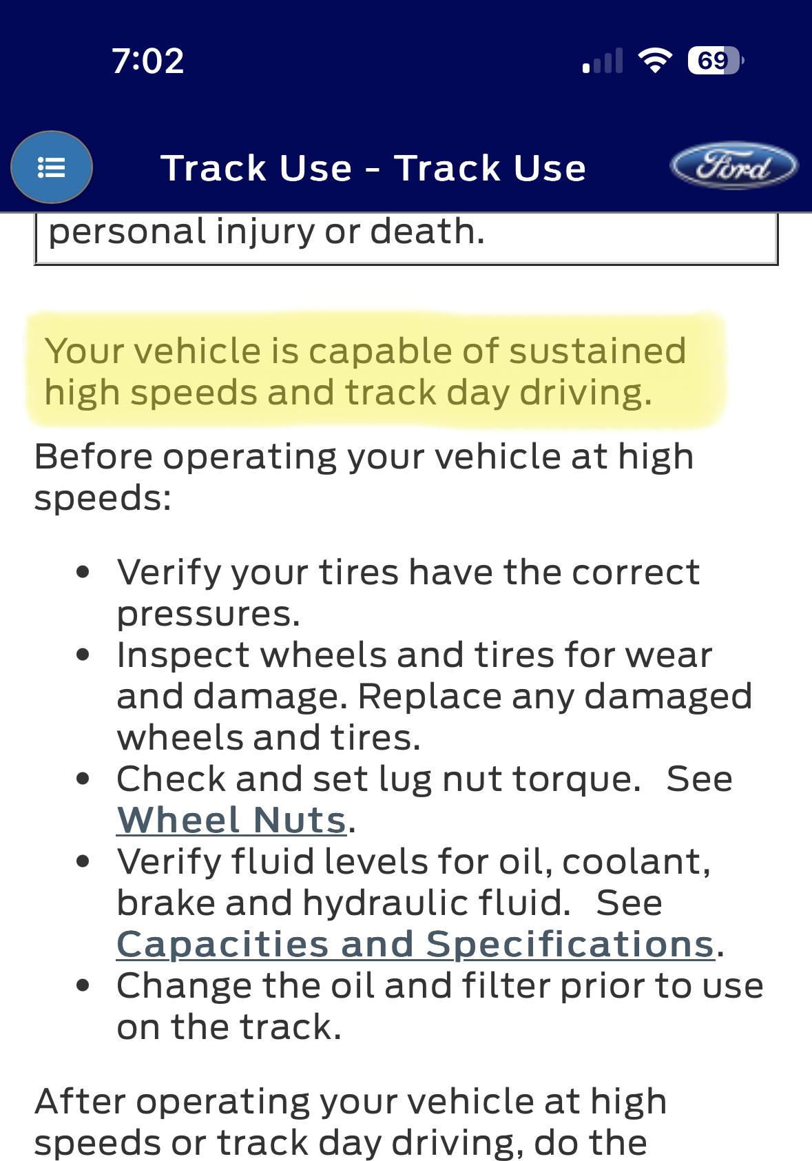

From the manual for GT and EcoBoost:
If all cars are as bad as MMRs I’ll cancel my order. Hopefully they just have a lemon.
