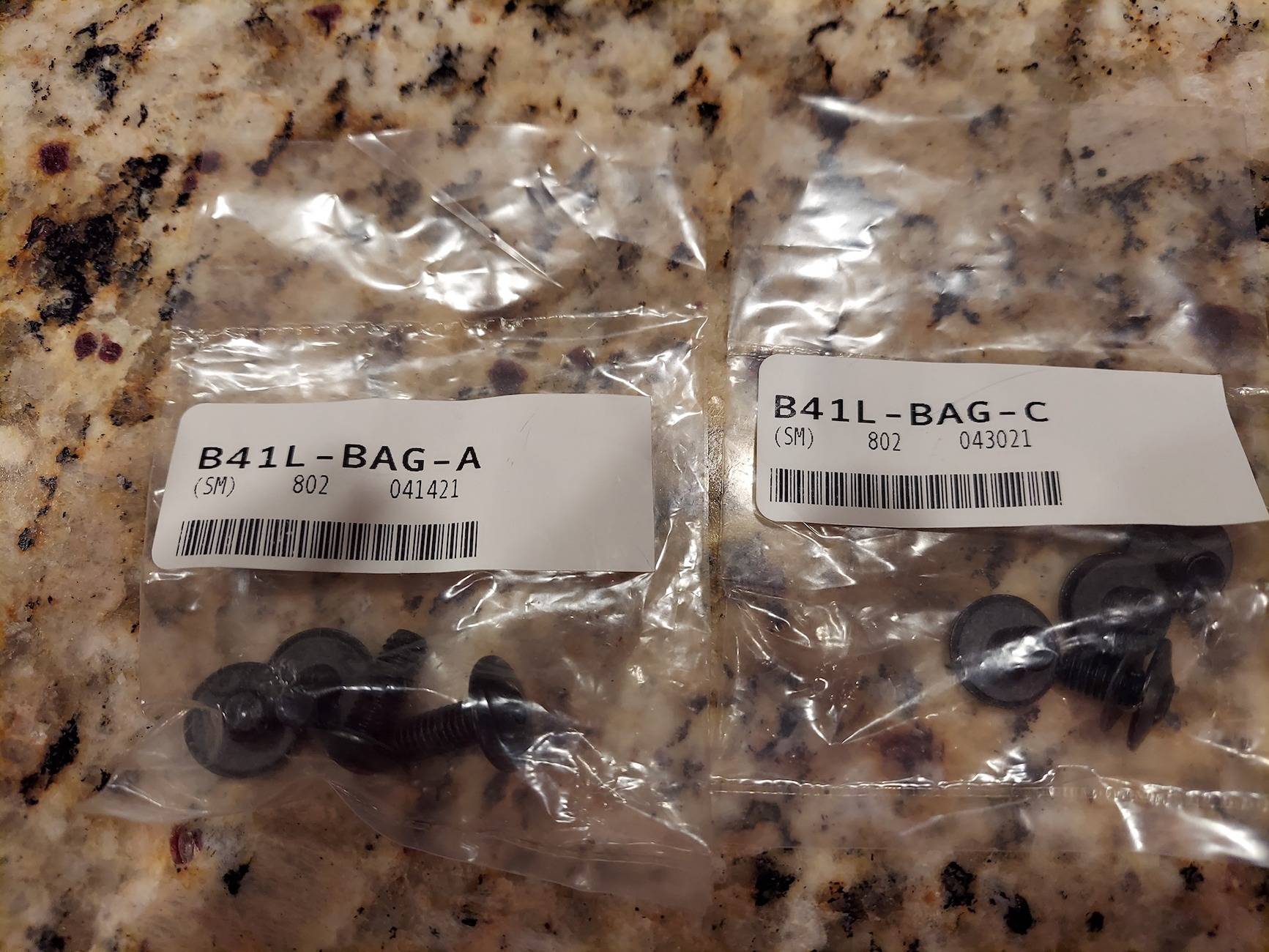

Has anyone else not received their longer bolts for the wicker? Do ya'll think it would be safe to just use the shorter ones or no ?

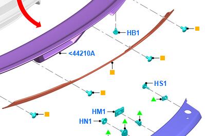

I do understand this was months ago. I had the opposite problem. When the dealer installed the Gurney flap, they used the correct screws. I later discovered they kept or chucked the shorter ones. Not big deal. There was a PN# for one item, both long and short; I bought that.
Attached is a pic of the procedure for the 550 wicker. Me? I'd use longer when installing the wicker.
*For those of you putting yours on/off, be mindful of the screws. DO NOT put the long screws back in the spoiler end after the flap is removed. You risk going to far and cracking the spoiler.
