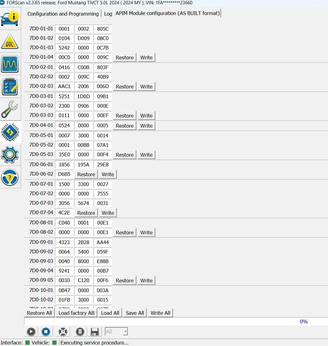

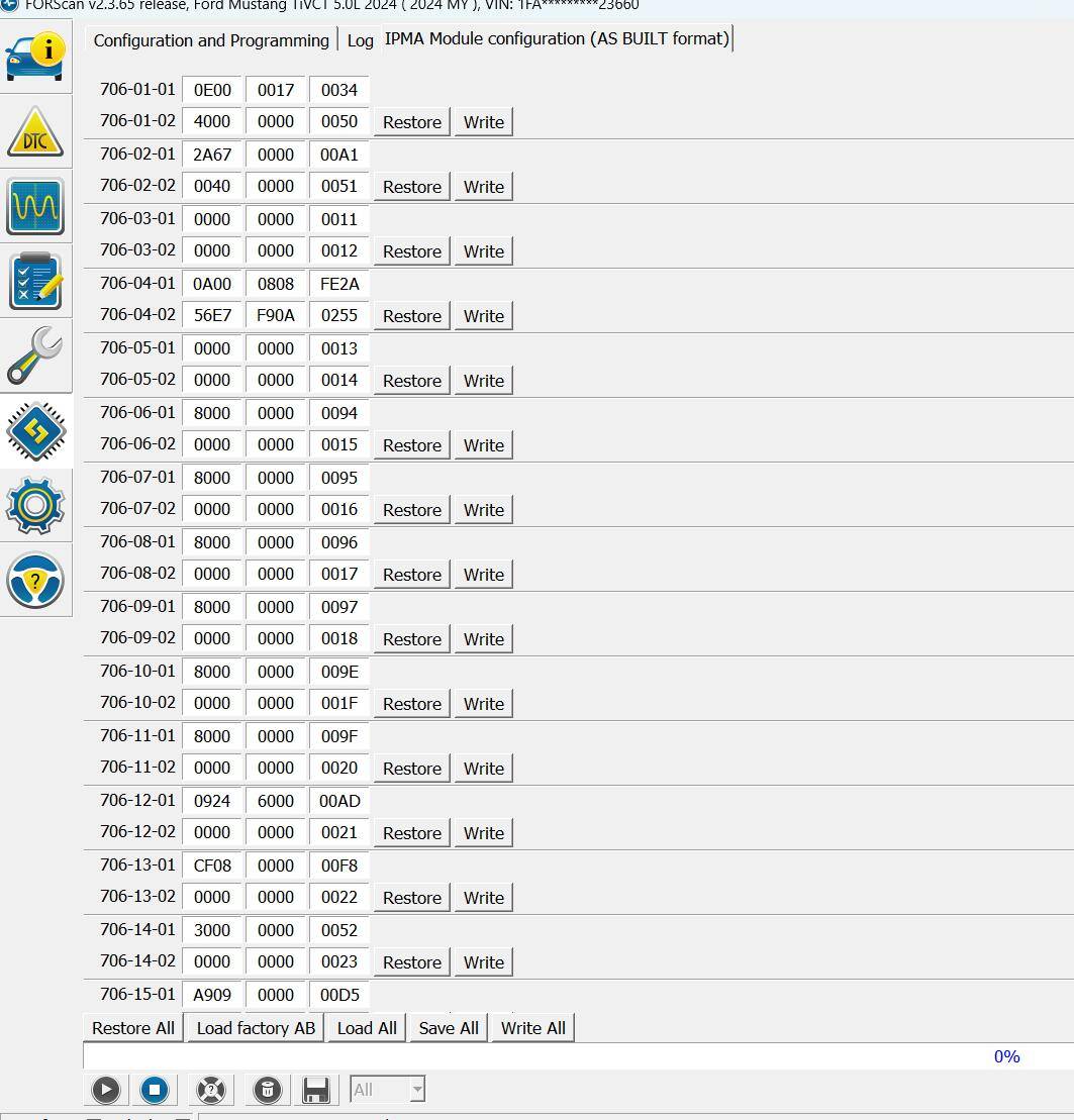

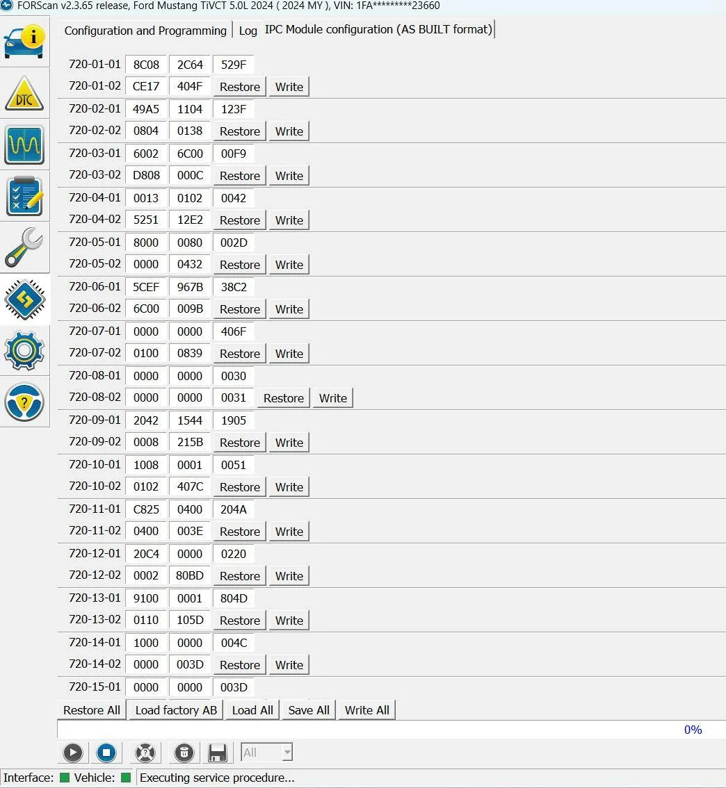

That's why I wanted to help you step by step and not just throw random lines so you can copy paste. Forscan does not always work like how you described. There are way more than 4 codes to change for this matter and not every Mustang has to change all these codes. Also, not every Mustang is coded the same, even when they are from the same region. So sometimes yours need a different number to change in the line than mine to make the same thing work.
If you can show me what you have on these lines, I will find out what you have to change.
APIM
7D0-05-01
7D0-09-02
7D0-09-04
IPC
720-03-01
720-03-02
720-07-01
720-09-01
720-09-02
720-10-01
IPMA
706-01-01
706-02-01
706-04-01
706-05-01
I was busy all day until now that I had a chance to go to the car and pull the info. Here the 3 screenshots that covers all the lines you were asking for. Thank you.

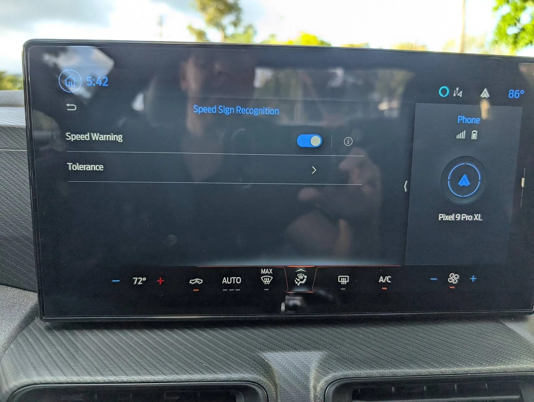

What country are you in and what kind of traffic signs do you have over there.
Just like USA and Canada? The white square signs or like the rest of the world, circle squares with red lines? This is important so your TSR will work according your region.
Also, do you have automatic or manual?
Meanwhile I'm going to do all other values for you and will be back for the changes.
I'm in Puerto Rico, a US territory so everything is just like in USA.
I have an automatic one.
APIM
7D0-05-01 2186 xxxx xx--
7D0-09-02 xxxx x500 xD--
IPC
720-03-01 x1xx xxxx xx--
720-09-01 xxxx xxxx 9x--
IPMA
706-01-01 xx4x xxxx xx--
706-02-01 6xxx xxxx xx--
After changing all the lines in the 3 modules, go to the wrench icon and reboot the modules one by one IPC - IPMA - APIM.
Good luck and let me know if it works. If not, than probably there is no hardware in your car that can make this work.

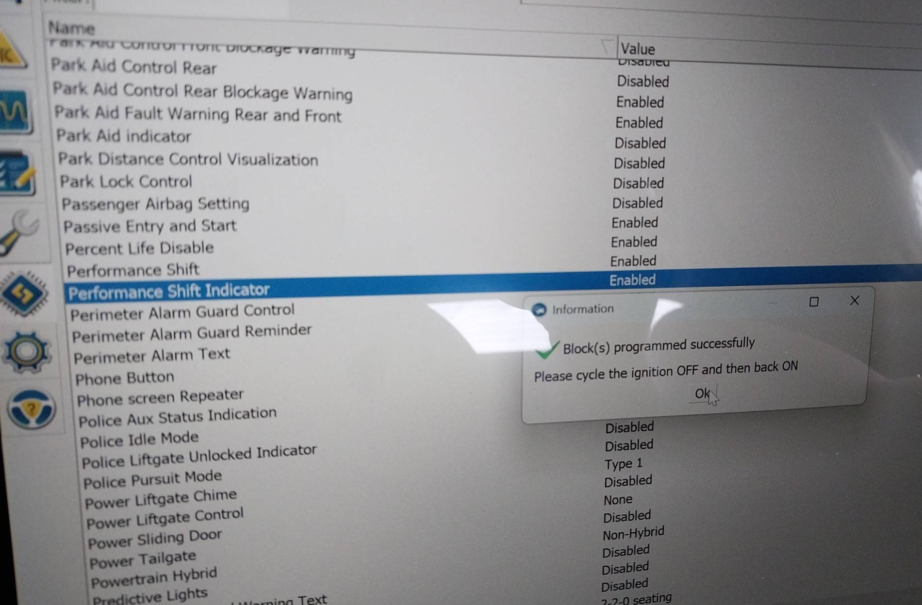

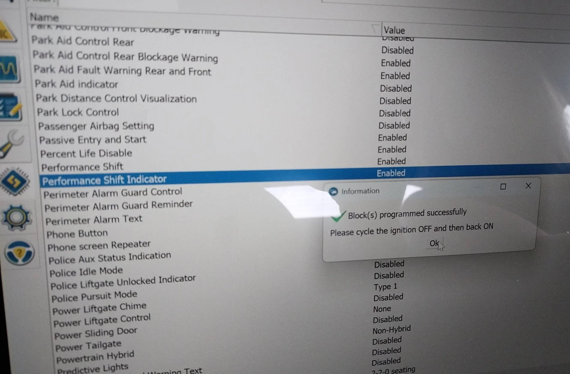

Thanks again to @roket that did the trick! In case anyone in the future has the same issue easy mode in Forscan did work.
You need to select in the IPC module "Performance Shift Indicator Enabled" and
"Performance Shift Enabled"
In the APIM module you would select:
I didn't change the Max and Min RPM values (APIM) and had no issues just like roket said.

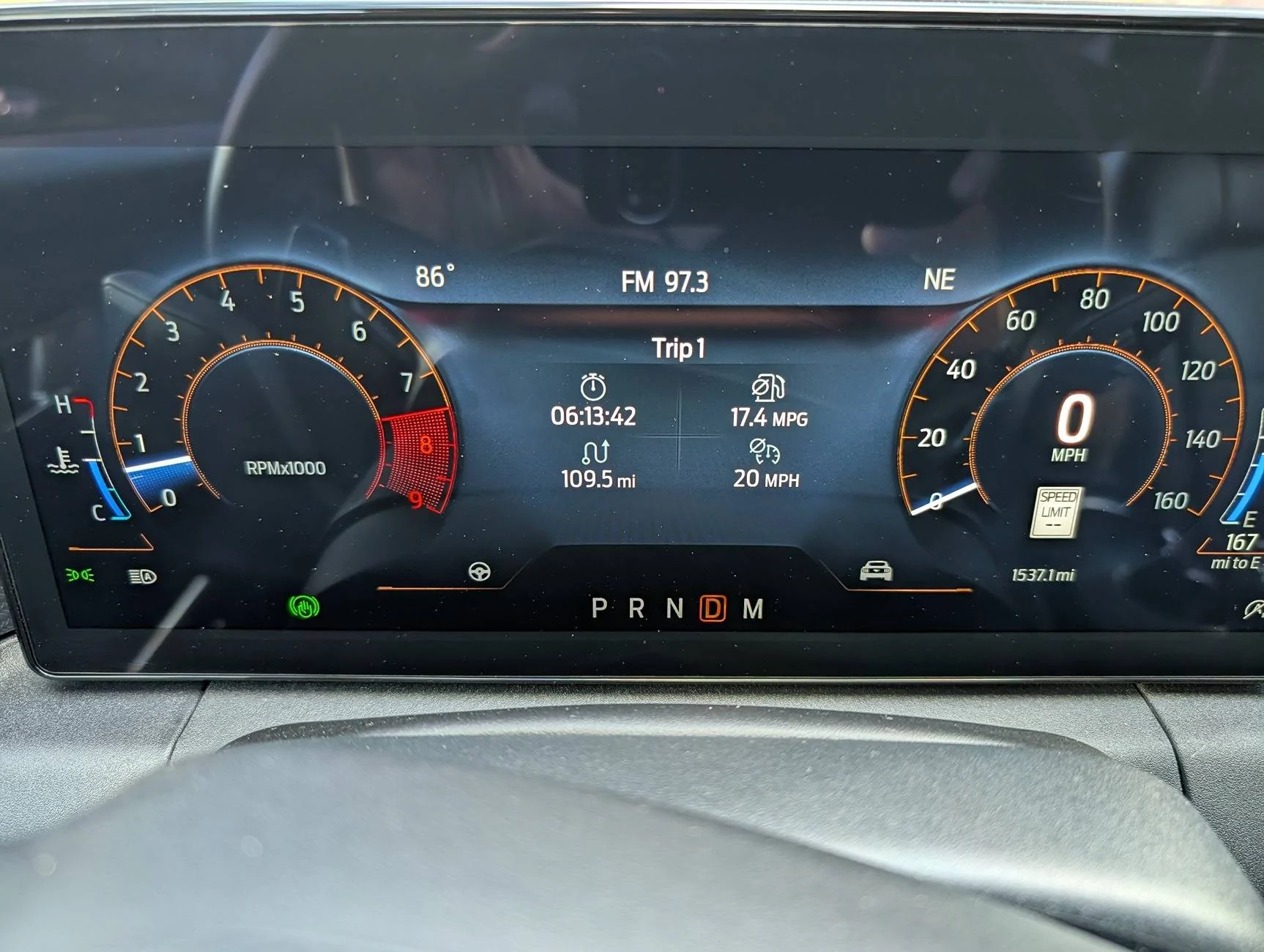

Do you have any video about this performance shift? I have no idea how it looks like and what it does.
