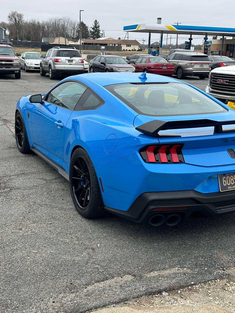

Another consideration. You didn’t mention which tire brand you are switching to. Makes a difference. Example: Michelin Pilot Sports have a straighter side wall than the Pirelli Trofeo’s, resulting in more tread width with a “smaller” Michelin tire. If you’re not careful, you may end up with a tire that fits a given wheel but the tread is wider & sticks out past the fender. Go to tirerack.com. The have the specs for all the tires that show the rim sizes that the tire will fit, the section width of the tire, the tread width, the diameter, and the revolutions/mile. Compare. I saw lots of pics of cars with aftermarket wheels/tire that looked like they would rub.
So, I took 2 pieces of blank paper & taped them together lengthwise. Then I drew the dimensions of my stock wheels. On that, I marked the midline & then the offset of my stock wheels. From there, I drew section & tread width of my stock tires. This was my reference that I knew would fit my car. From there, you can compare drawings of other wheel offsets & different tire sizes. I was surprised to find that some “smaller” tires were wider than my fenders.
I ended up going from Pirelli Trofeo RS 305/30/19 & 315/30/19 to Michelin 285/35/20 & 305/35/20 with more tread on the ground front & back, good full fit, & no rub. Pics on my recent thread
