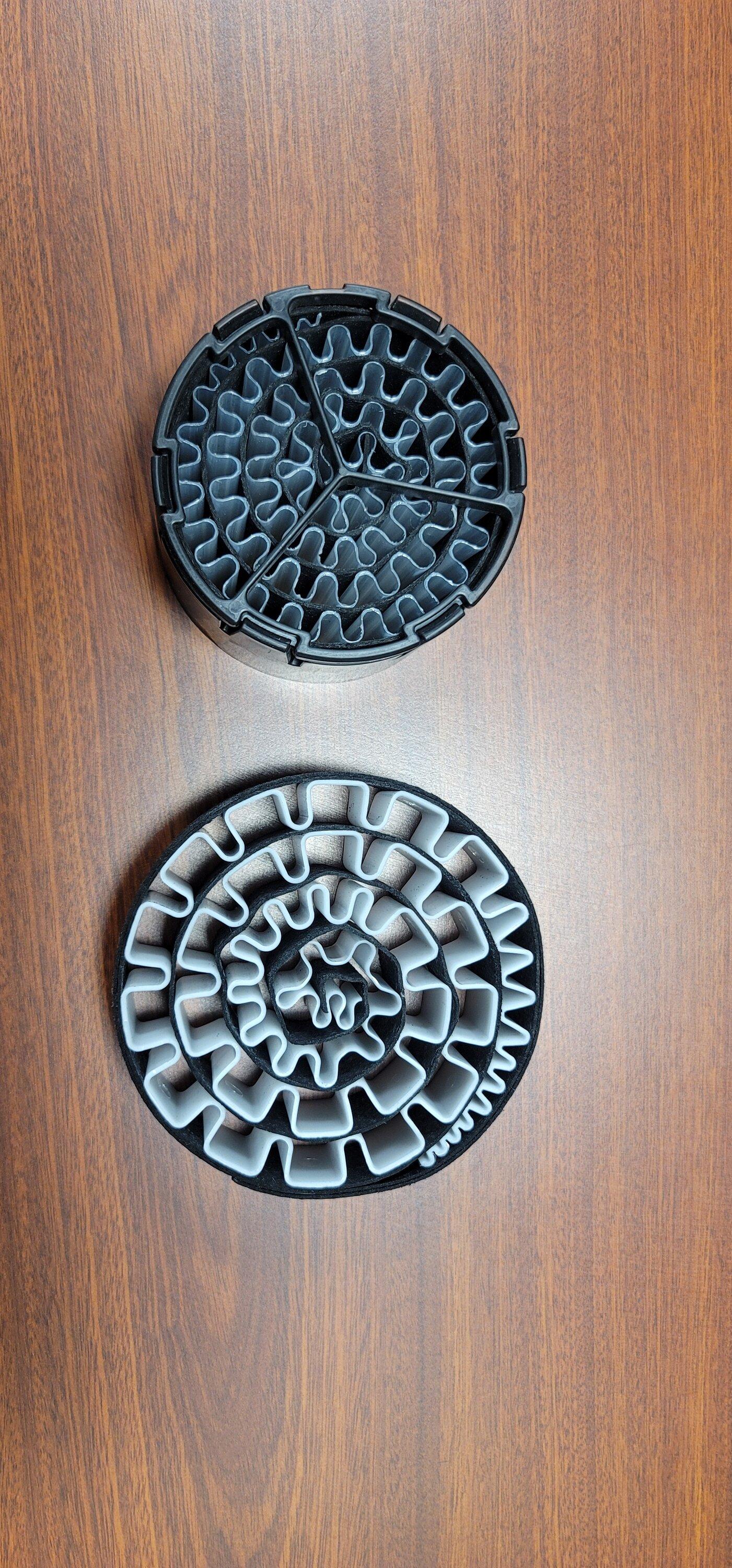

Mach 1 vs Dark Horse hydrocarbon filter
top is Mach 1, bottom is Dark Horse
Is it the photo, or does the top look more restrictive? I get the shapes are slightly different, but the top looks more "tightly packed". That could somewhat corroborate the people not seeing the same gains the Gen3s got when removing.
