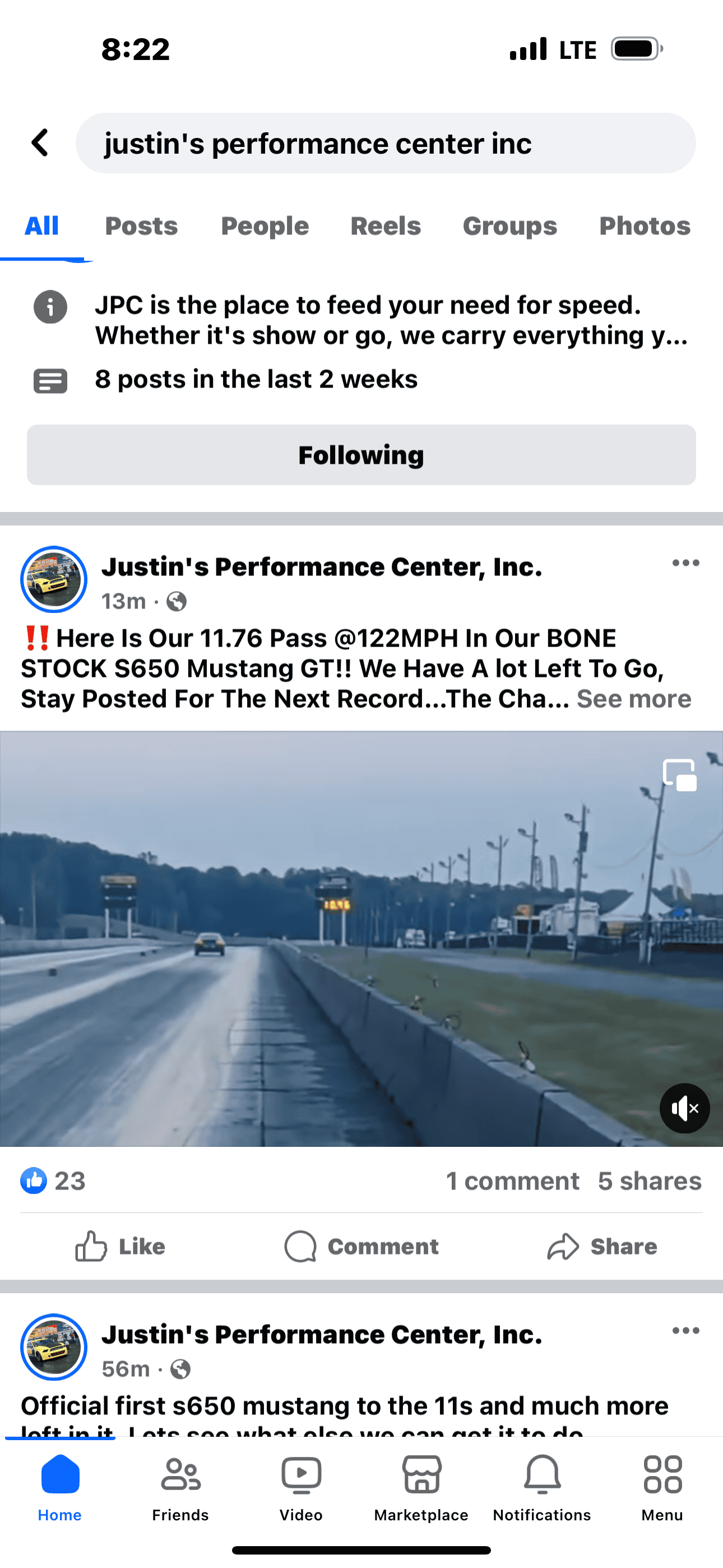

Was that run made by a horse jockey? Who happens to live in a mineshaft? Which happens to be built in a solid chunk of ice?
Jokes aside, I'd love all the details on how they achieved this run. To say those numbers are insane, is an understatement...especially the trap speed. Anyone have any deets?

Bone stock isn’t showroom stock.
Stock engine as delivered from the factory, factory tune… that’s bone stock.
Coyote stock runs 9s on sealed stock coyote engines.

Bare bone [stock], bone stock, showroom stock: common = no tune, no adds only deletes, stock
