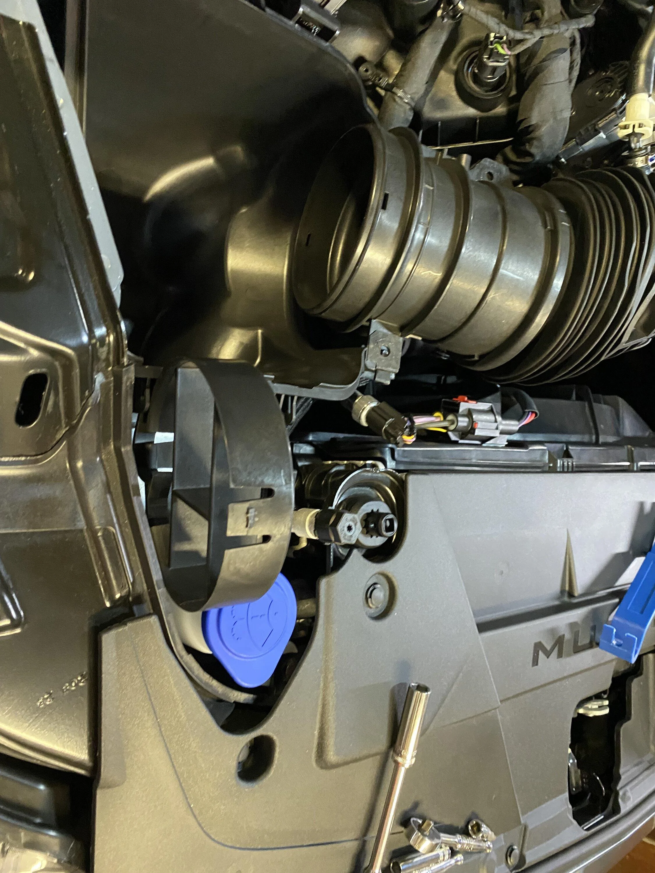

Removed mine a week ago, really easy, just loosened the intake tube,removed the end vane,carefully unscrewed and pulled the sensors still plugged in out of the way, left the molded triangle pieces in place and used needle nose pliers to unwind the carbon and plastic windings ,reinstalled end vane put back together.. no need to pull the whole tube assembly off…
I think i like that option better.

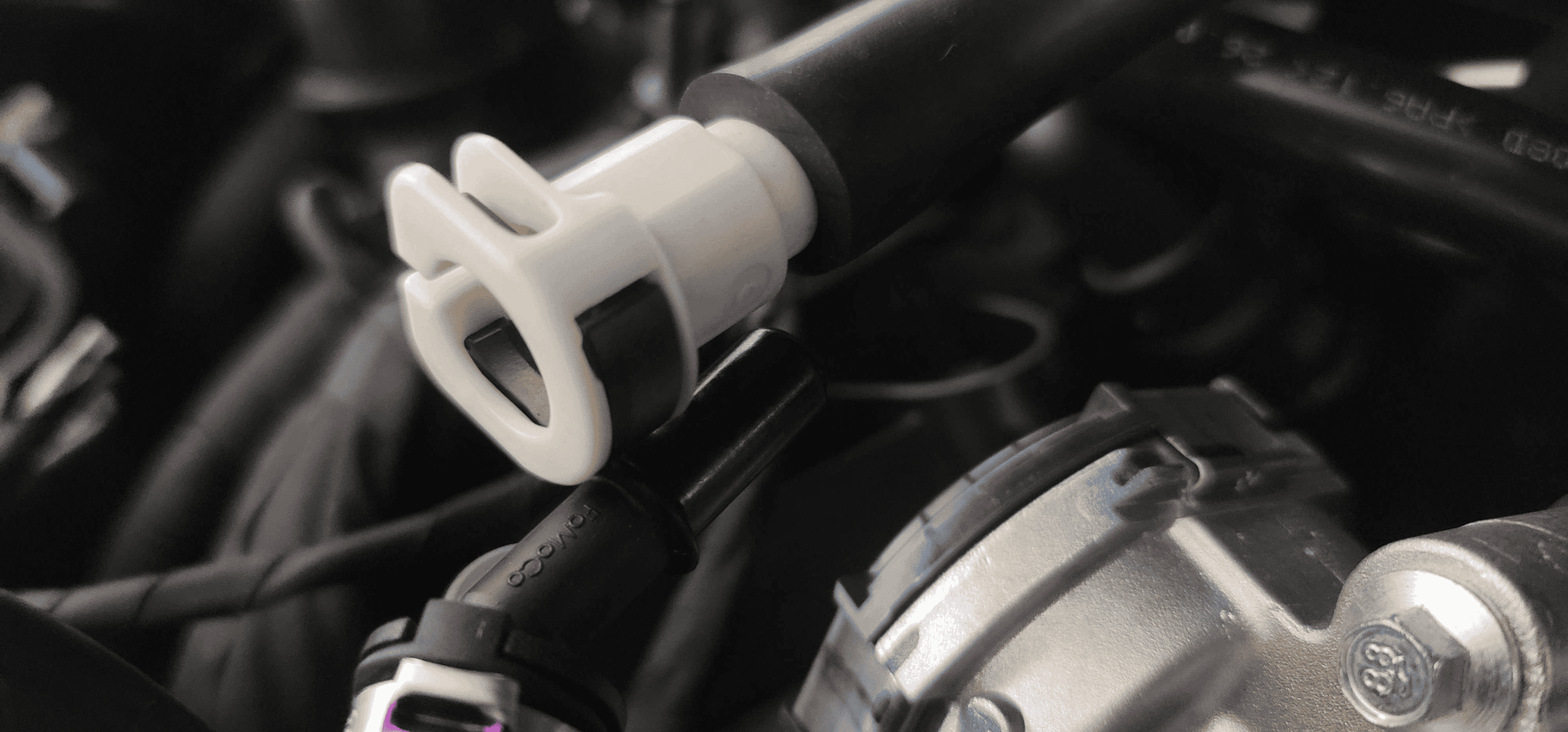

5. Disconnect the crankcase hose. Driver side has a blue clip that you reach under, pull it towards the front of the vehicle, and pull the hose off. Passenger side has a black push button that you push in and pull the hose off

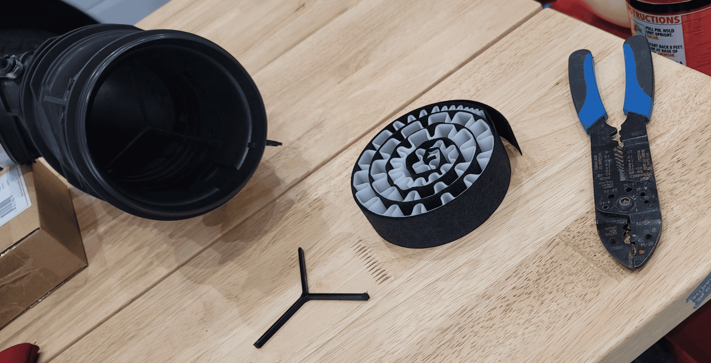

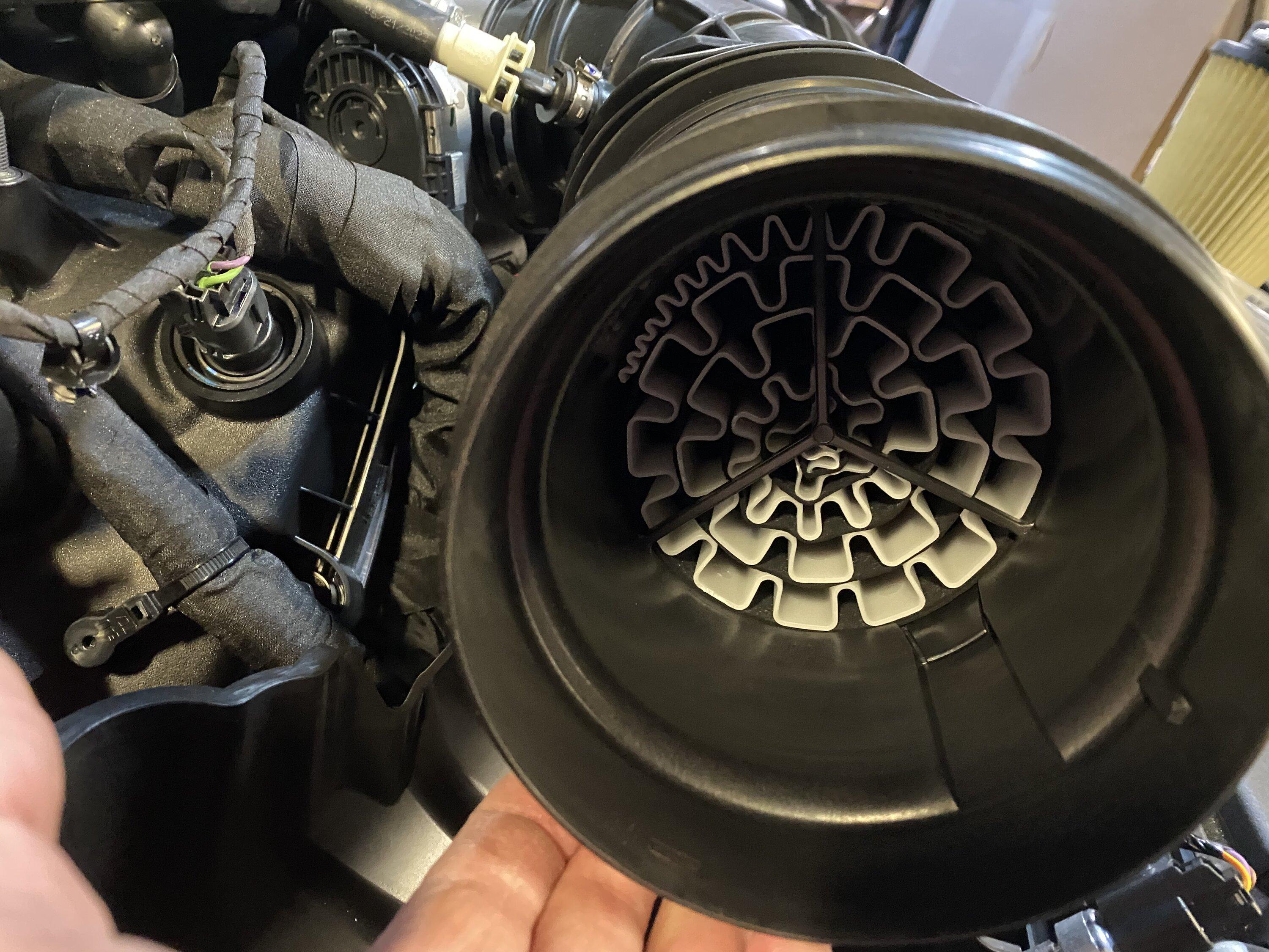

7. At the end of the tube where the filter attaches, there should be a sort of plastic grate that makes an "H" shape. This is an insert and on either side of the insert there are little clips. pull them inwards at the same time and pull the insert out
8. Further in the tube is a 3-spoke structure holding the hydrocarbon filter in place. use the cutting tool of your choice to cut each of those spokes as close as you are comfortable with to the base on the outside of the tube
9. Put your hand in the small end of the tube and push the filter out. then repeat what you did for step 8 on the second 3-spoke structure
