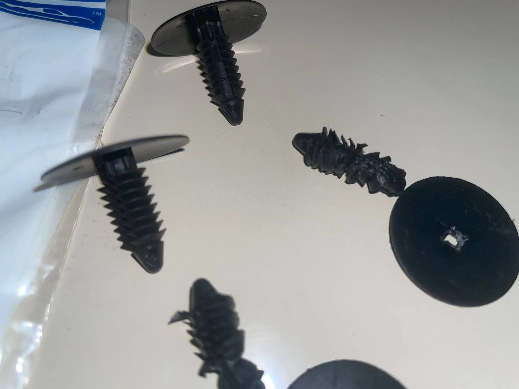

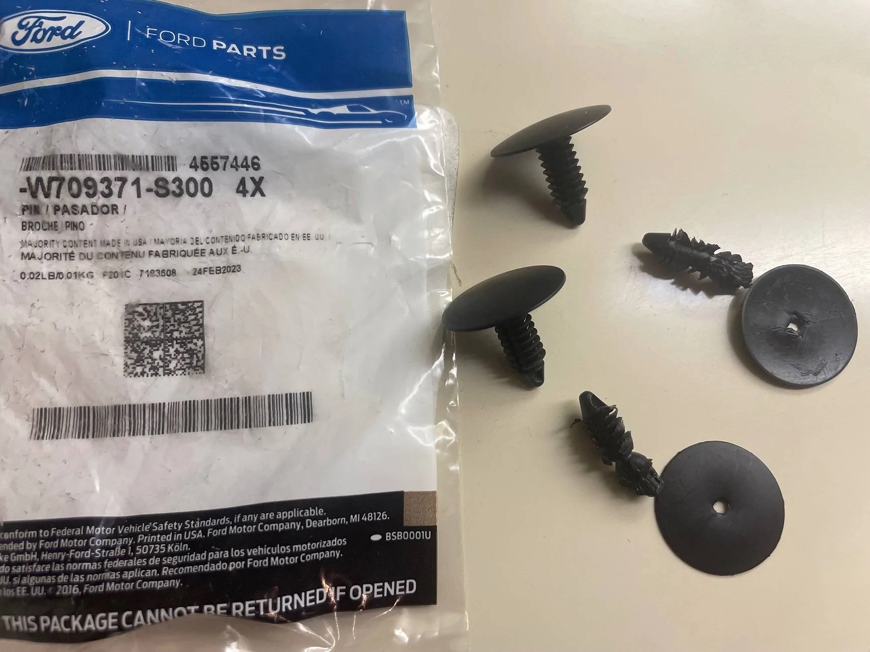

I don’t believe W711687-S300 is correct. Instead I the got W709371-s300, and they look exactly like the Au-Ve-Co Chrysler spec 23966 as well as the ones I pulled out (definitely one-time use). This was confirmed by a local dealer who had to look it up by part number to show it fits the 2024 Mustang GT belly pan. Looking up the belly pan showed the 15 screws and 4 of the other push in type, not 2 of one and 2 of the other.
The Ford branded ones come in a 4 pack and have the same indent in the tip and slot on the shaft (cue the “that’s what she said” jokes) as the Chrysler spec ones. They’re pretty hard to find in stock locally. I had to drive 90 miles to snag a pack. My nearest dealer was out, the next closest had 8 in stock, but they were precommited, then the next closest dealer in the opposite direction had 2 in stock that were also precommitted. Finally a dealer had 4 in stock that I could buy.
Here’s pics of the 4 pack, the remaining 2, and the ones that had to be surgically removed.

@DarkMatterGrey ..... well that's interesting - I took the part numbers right off the two different Ford packs and they fit my 2024 GT (built Sept 2023, if that makes any difference).
Mine is a late 2023 as well, 11/29 to be exact. I put waaay too much research in to this. Even compared the ones from Dorman at a local auto parts store and Hilman from Lowe’s. Nothing is close except for the Ford ones and the matching “Chrysler” ones that I have in my response above. I guess there’s a chance yours was different. Do you happen to have any pictures of the old vs. new?
