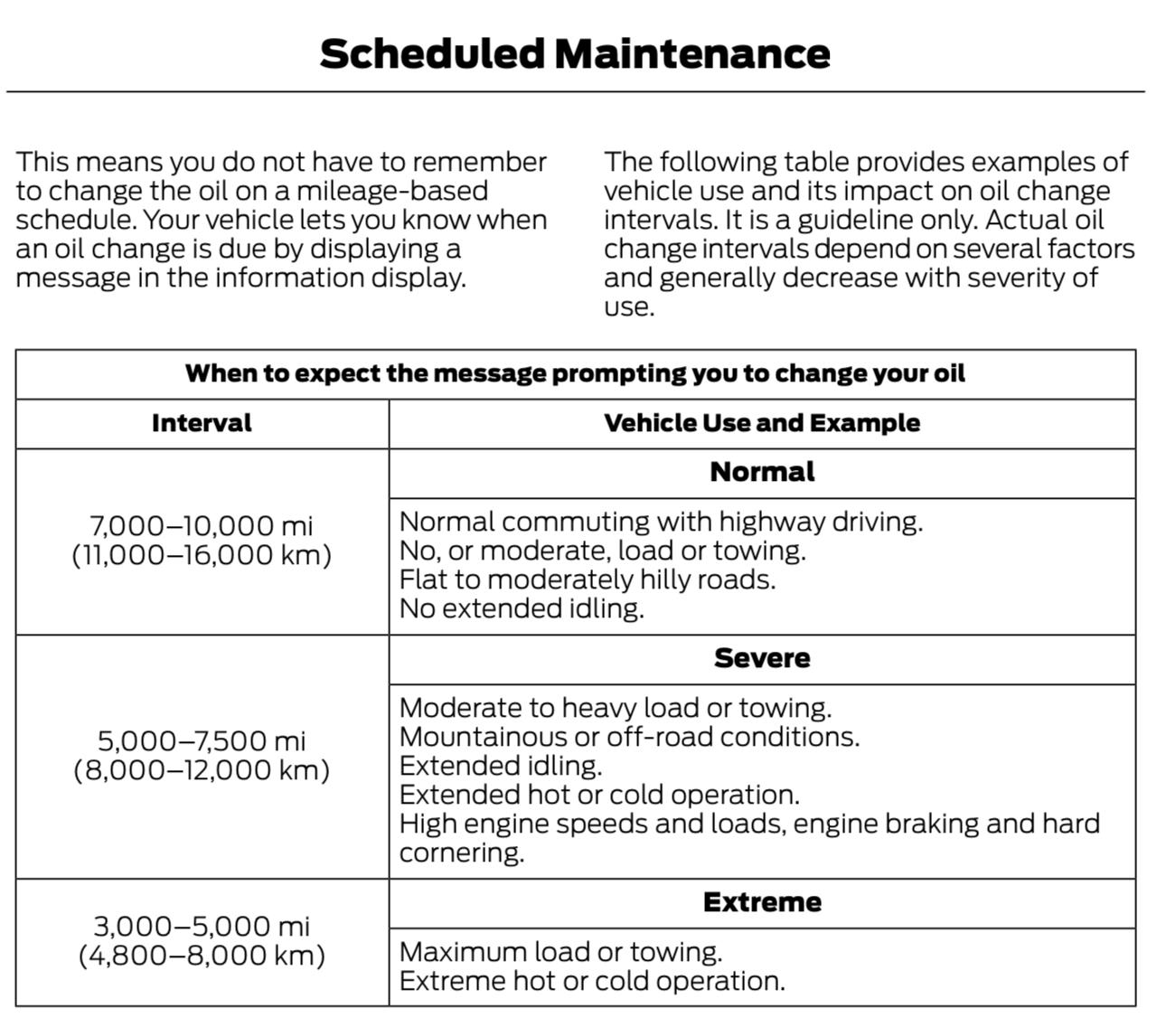

Enlighten our foolishness, as we never owned sports cars or serviced them it seems.
If i don’t track my car at all and usage is limited to casual sporty driving, Why would it classify under Severe or Extreme.
And even in Severe the service interval is ??? Look below buddy.

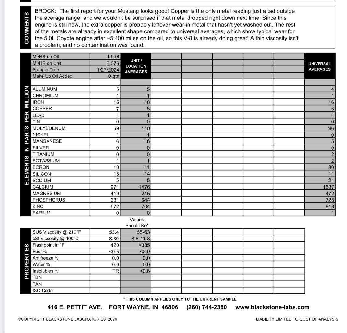

Here is my second oil change oil analysis. You can see there were still some break in materials in there but not a big deal. I put this oil in at 1300 miles after draining the factory fill.
