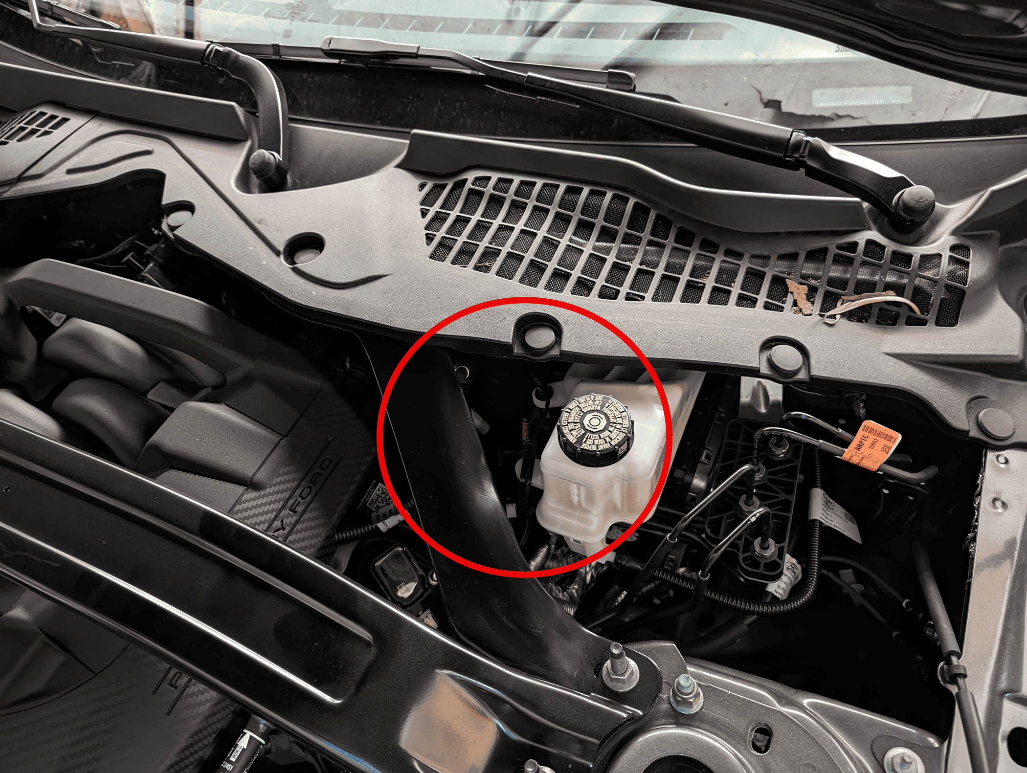

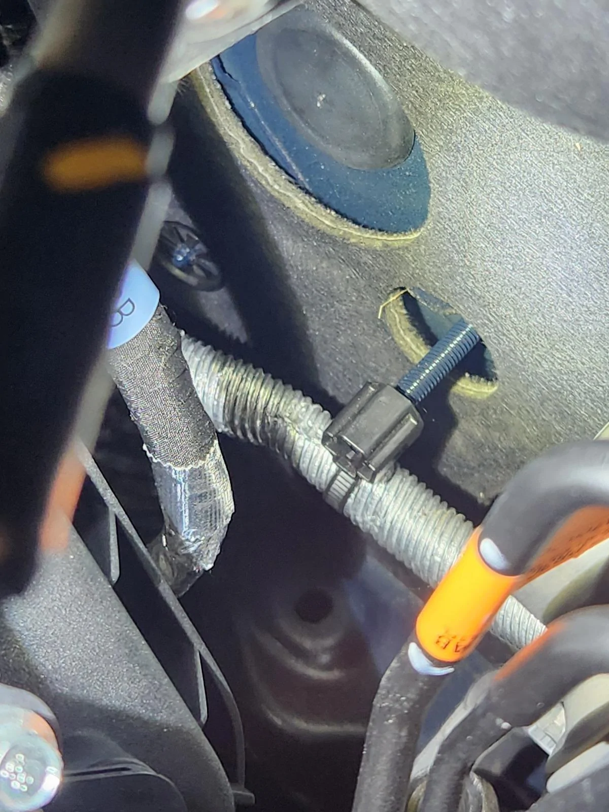

Howdy all. Whelp... guess I may be one of the "affected" ones. This is what I think they're looking for:
Area Looking (right behind driver's firewall):
Suspected problem child:
For those that are curious: mine was mfg in 06/23 - 401A GT PP

According to the ole' dashcam the tech only had it on the lift for about 30 min (the cam only records when the car is on and for about 2 min after shutoff so I didn't see what he did under the hood/where he worked). As I know mine was a fail (wasn't on the post at all and I left it that way) I don't know if that was long enough to do a whole clutch line replacement and bleed. Either way they said it was good and afterwards it's on the post. I did a longer visual inspection to look for any discoloration on the shielding and couldn't see any so calling it good for now (but the fire extinguisher's going to ride trunk for a few more months, lol). As far as I can tell there's no difference in clutch feel/contact patch/engagement zone after the service.
