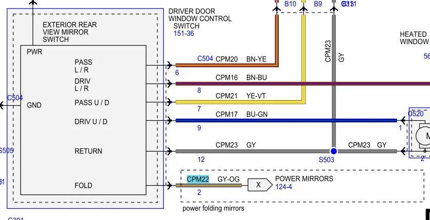

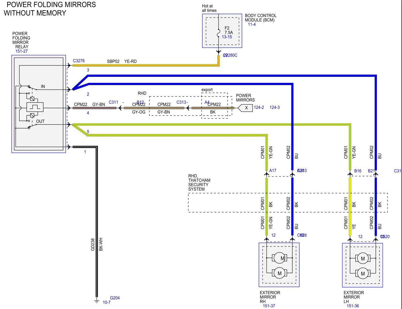

Folding is not much extra efford.
From the S550 (S650 should be the same).
The relay is located next to the BCM.
You would first have to find out how many free connector cavities there are in the door plugs, on both sides.
S650 Mustang Recaro seats will delete your turn signals. WHY? 1736438224219-d4
S650 Mustang Recaro seats will delete your turn signals. WHY? 1736438334631-83
