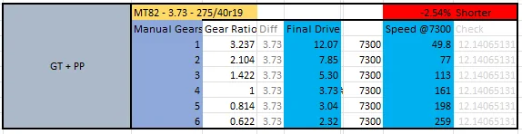

Mustang GT+PP back to back with Camaro SS.
Camaro SS - TR6060 - 3.73 - 275/35r20
S650 Mustang Went to test drive a GT 6spd.... Is low end torque improved in the S650? 1713391719768-jx
Mustang GT+PP
S650 Mustang Went to test drive a GT 6spd.... Is low end torque improved in the S650? 1713390724475-jd
The mustang has shorter ratios but makes comparable max speed throught the gears because it can rev higher.
In comparison, the camaro has longer gearing because of the TR6060.
Look at the final drive column.
The SS has 455 torque
The GT has 415 Torque
Diff 40 lbs-ft or 8.7% less in the GT.
Comparing 2nd gears
GT Final torque @ wheel: 7.85 * 415 = 3257 (7.8% more torque at the wheel)
SS Final torque @ wheel: 6.64 * 455 = 3021.
(wheels are same diameter BTW, so no difference there)
IMO the MT82 makes up for the lack of torque in the first 3 gears, and the higher reving 5.0 turning faster compensates for the lack of speed in every gear.
This changes in 4th gear since they're 1:1, but at that point what matters is power, nobody does a roll from 40 in 4th gear :)
To be honest PP shouldn't matter that much from a "fun driving" standpoint. The feeling when rowing gears should be pretty much the same.
And for those who never drove a camaro, The manual does feel sluggish, the A10 really wakes up the car.

looking at my last post:
Comparing 3rd gears
GT Final torque @ wheel: 5.30* 415 = 2199
SS Final torque @ wheel: 4.85 * 455 = 2206.
0.3% difference. Should feel the same from max tq to redline, car weight and aero can make the difference here.)

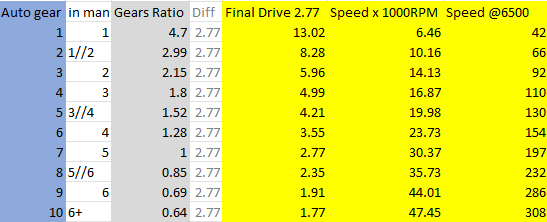

Aren't the manual Camaros closer in speed to then A10's compared to the big difference between the M6 and A10 Gen 3 Mustangs?
I haven't done the A10 for the mustang yet, but here's the Camaro A10/M6 comparison.
The 2nd column compares the auto with manual gears. There are some in betweens that make the difference when it comes to acceleration.
S650 Mustang Went to test drive a GT 6spd.... Is low end torque improved in the S650? 1713396210725-pk
S650 Mustang Went to test drive a GT 6spd.... Is low end torque improved in the S650? 1713396220860-24
The problem with the A10 is that 1st gear is already too short. IMO this is on purpose to shift to 2nd and lock the converter ASAP to reduce the drivetrain losses. If you pick a shorter Gear, it needs to turn 2nd/3rd/4th/5th in "in between" gears. The approximate drop/ratio between those gears is 21%. If you shorten the differential around that % you're just swapping gears, 3rd is the new 2nd and so on... and 1st is useless. So you turn a 10 speed into a 9 speed with a crawl gear.
It's very hard to improve this setup.
The TR6060 has the gears closer than the MT82, that's good as long as the final ratio isn't too long.

I'm just talking about 1/4 mile times and trap speeds

All theory is grey as in real life the Coyote needs at least 4000 rpm to get some meaningful acceleration while the LT1 get you the same shove around 2000 rpm…More Torque due to bigger displacement ! Nowhere between 1000 and 6000 rpm will be the Coyote as powerful as the LT1 or even less so the Hemi 392 except for keeping it spin at 6500 rpm…This of course you cant do unless you where on a track or had a CVT…LOL And yes in a automatic with 10 gears you can keep it closer to the rpm band where it makes the best power , between top torque and top power than in a 6 speed manual with bigger rpm differences between the gears but a manual will always be more fun despite being a little slower on acceleration…Unless you live in San Francisco or go drag racing go with the manual 👍
