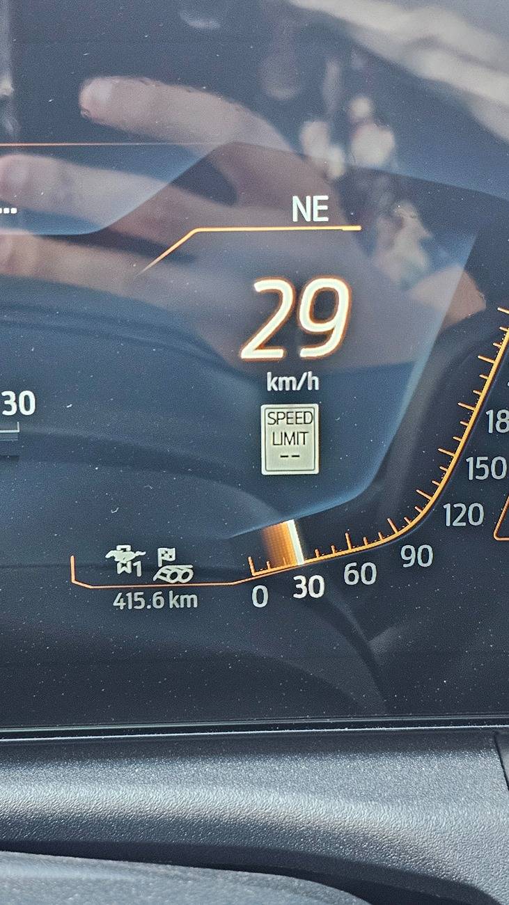

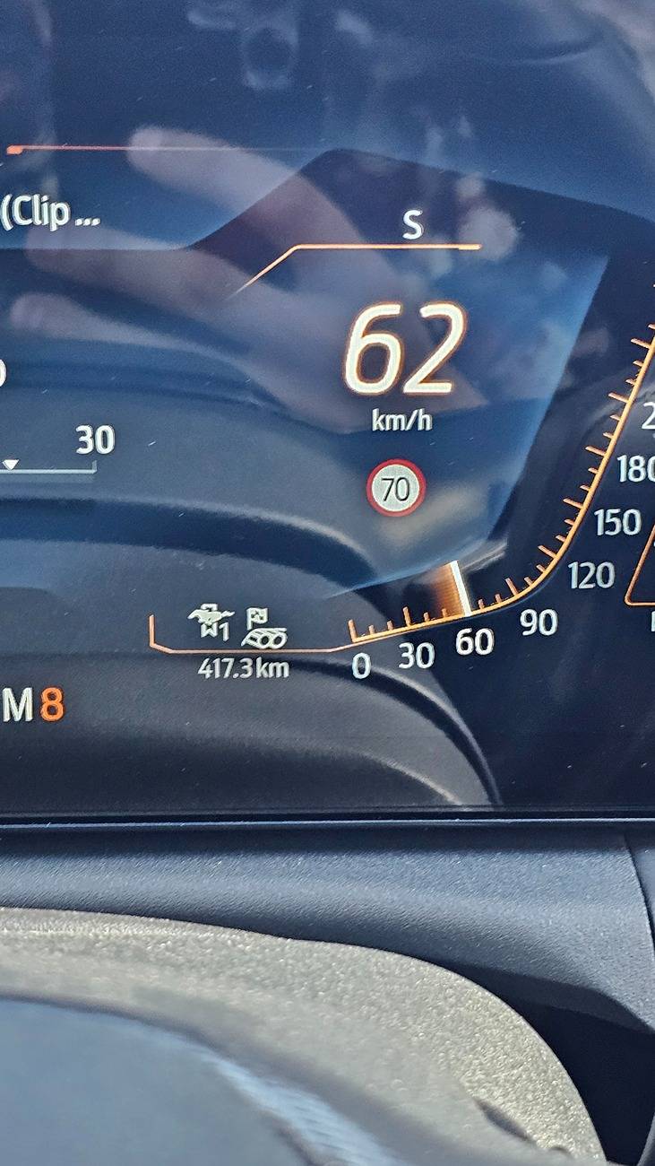

Today I changed Traffic Sign Recognition to the European model so that it will recognize European speed signs.
Everything worked well, my car now can read European traffic signs. But when there are no signs to read on the road, it shows the American white rectangle speed sign instead of the European one. This is just a cosmetic thing and does not do anything bad.
Then I noticed on 1 of your pictures you posted, the same American speed sign shows on your screen as well. That means it could be 1 of the 2 things.
1. Showing the American speed sign is normal on all Mustangs, so there is no way to change that speed sign to the European one.
2. Your Mustang is from the American market as well and you also have to find the adress in Forscan to change that.
See pictures below, 1 when the TSR reads the sign and 1 when there are no signs to read.

I'm pretty sure mine shows two dashes in a white circle in that scenario.
Hmm.. than I still need to find the line in Forscan to change this one out. It's just a cosmetic thing because everything else works.
