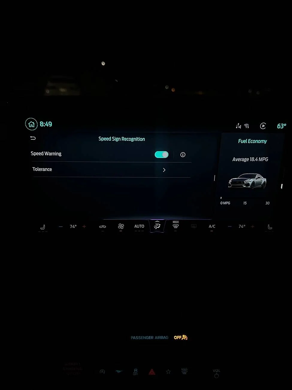

These are my options in that menu, no speed sign recognition, but I actually don't need that anyways since it doesn't give you anything extra. Only curious why yours showed up and not on mine since I have this option from the factory.
In case you want to know here’s what the setting shows that you’re missing:

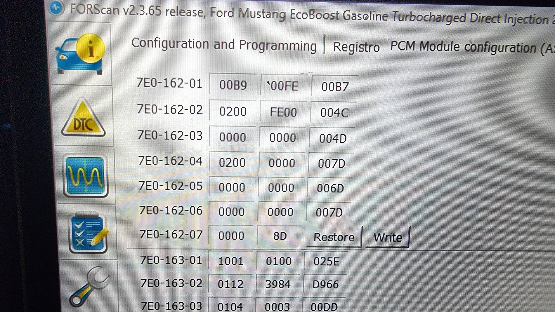

Acabo de cambiar 1 a 2 pero no puedo obtener las revoluciones remotas.
Are you sure you're changing the right address?
If you're using the latest ForScan version, it is: 7E0-162-04 to x2xx xxx xxxx
