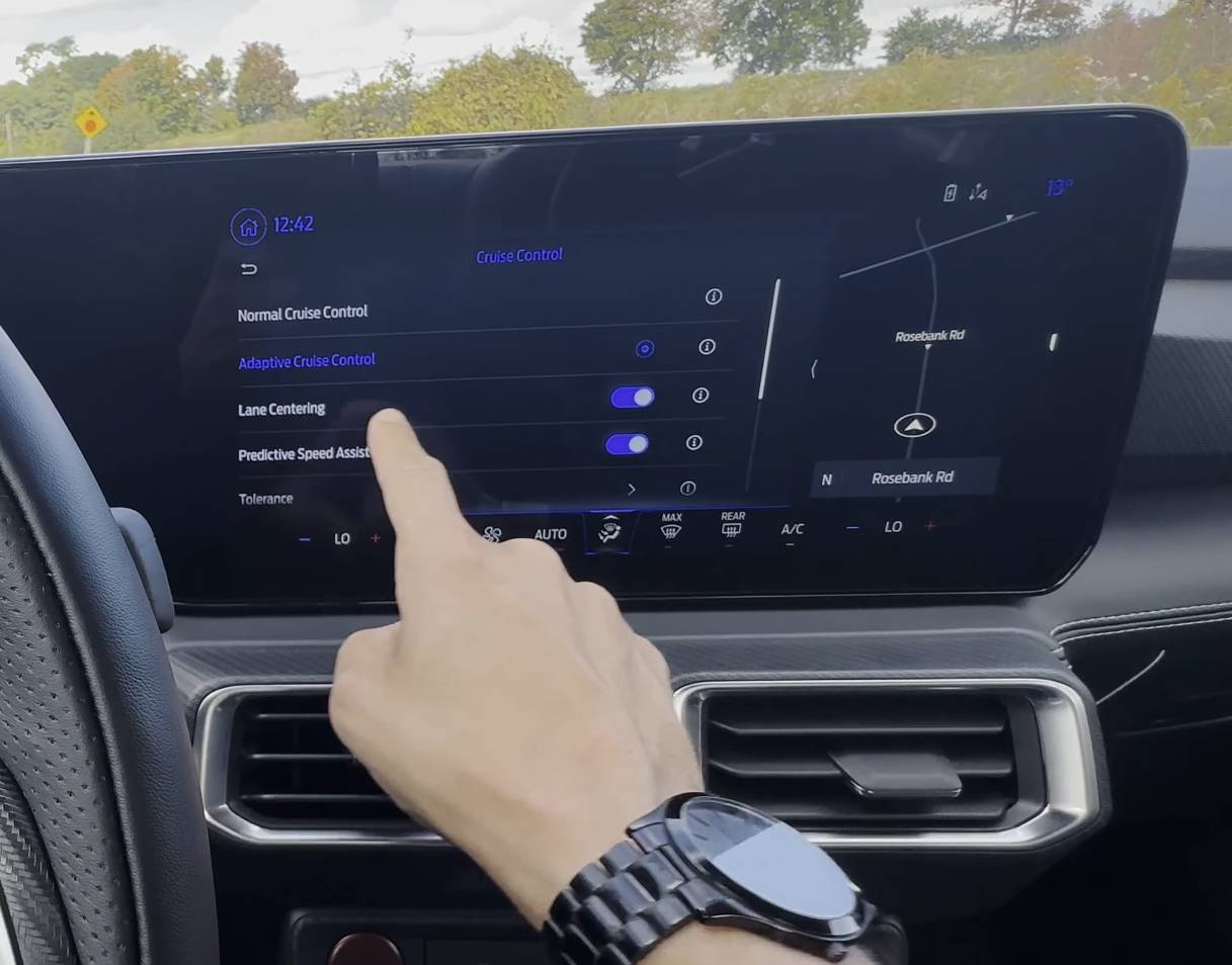

Yeah I’m in the same boat as erasat, I’m just interested in the improved cruise control if it’s even possible. Personally I doubt it’ll do anything. However if there’s a small chance that it improves it I’d love to test it out. Isn’t lane keep assist even improved with the advanced cruise control? I know my buddy says it basically drives the car for him and he only has to nudge it every 30 seconds with cruise control.
This is my first "high tech" car and I just own it for 2 months now. My last car was from 2011 with just basic stuff on it.
I live on a small island at the moment, so I haven't had the chance to test and experience all these new features out that my car has.
I can only see that I have all those options so I can compare my data with other similar cars from USA, Europe and Middle East. I made a list from all AS built data that I have from different trims and different specs so I can compare every value with each other and see what should be turned on and what not.

Just a follow up, I watched a YouTube video on the actual settings and if we can get it actually enabled I’m pretty sure it’ll work. In the settings you have the option to change regular cruise control to advanced cruise control and you can enable basically everything in the sync4 menu. You just can’t adjust the button toggles which is fine. I might try and find a way to buy wrecked cars steering wheel and take that button and swap em out to try if it works. And the lane centering is exactly what I’m actually looking for is to keep the car center (I had to drive a 2025 Camry last month as a rental and I got SPOILED with their lane centering)

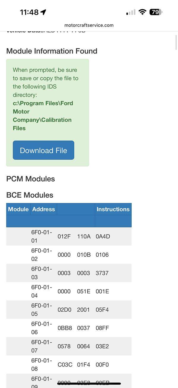

No I mean you grab the vin number, and enter it on the website I listed above

@erasat it gives you all the ASBUILT data on https://www.motorcraftservice.com/AsBuilt
Without needing your computer or even needing to be at a dealership you just gotta grab the vin from their website and download it and convert to a text file to upload on here (at least from what I’ve read previously you have to convert it idk for certain) and I’ll include an example photo of me using my vin
Ohh I totally misunderstood, ok that's more possible. They have 1 Premium one without Performance Package, so it won't be exactly as mine because I have the Performance Package but I think for these purposes it may be useful as what we are looking for here is just for tech purposes.
Thank you for the suggestion.

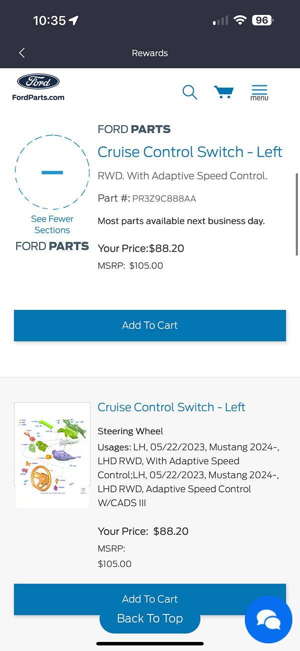

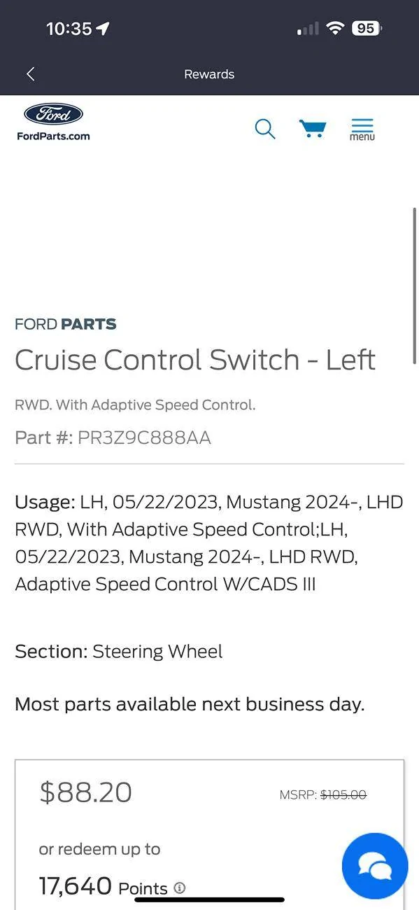

Also found the part to give us the buttons for the other two features in adaptive cruise control (IF) the changes work later.
Only gonna be $88.20 + tax to swap them out so not too bad.
