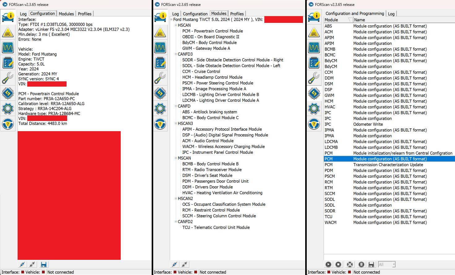

So it's not the cable... What does it show in the PCM Module Configuration tab?

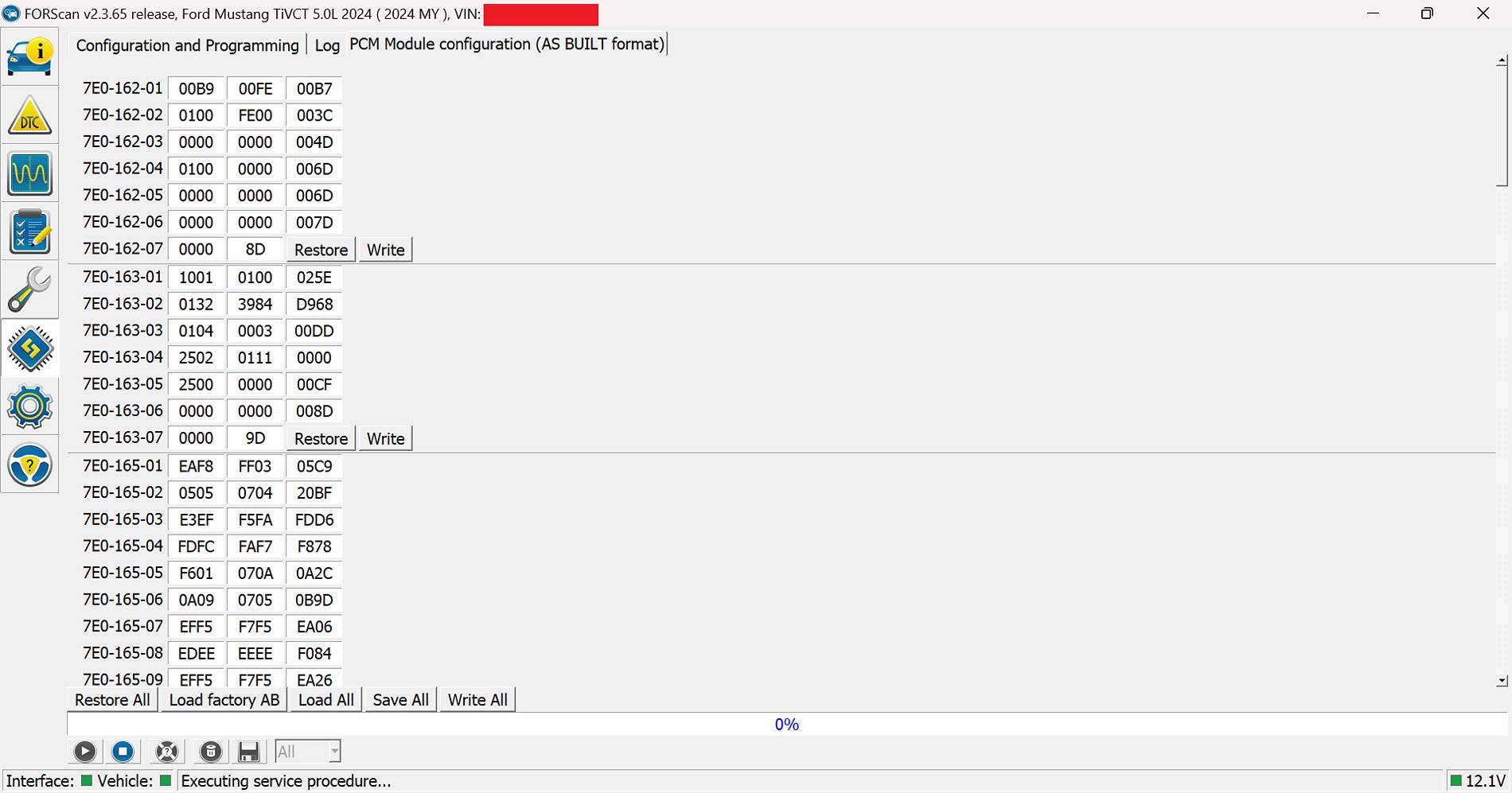

Just the blocks 162-165. Let me grab another screenshot :)

Unless it's your first time with FORSCAN (first time created a profile), try to delete the current profile and create a new one.
As said when I had a similar issue, it was the cable, but you deffo using my same (new) cable, so I doubt it's it.

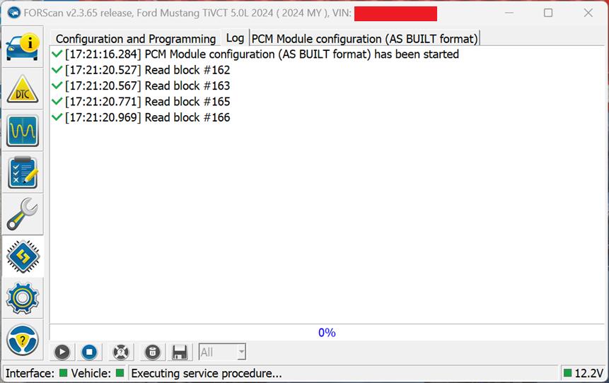

I've now tried everything I can think of:
  • Clean install of FORScan version 2.3.65 after uninstalling and deleting C:\Users\{USER}\AppData\Roaming\FORScan
  • Remove FTDI chip USB drivers and re-installed latest (v2.12.36.20)
Still no luck unfortunately. Thank you for your assistance though npole. I'll keep trying, and maybe I'll contact FORScan directly.

I tried today I got the same addresses as you this is my first time using forscan I was trying to enable remote rev as well but no luck

Just connected today for the first time and ran into the same issue... I want to enable SST for an EcoBoost without paddles but am only getting 162-165. Car is a Job 2 2024 (06/24 build).
BCM lines past 96 also do not appear so no walk away lock capability...
