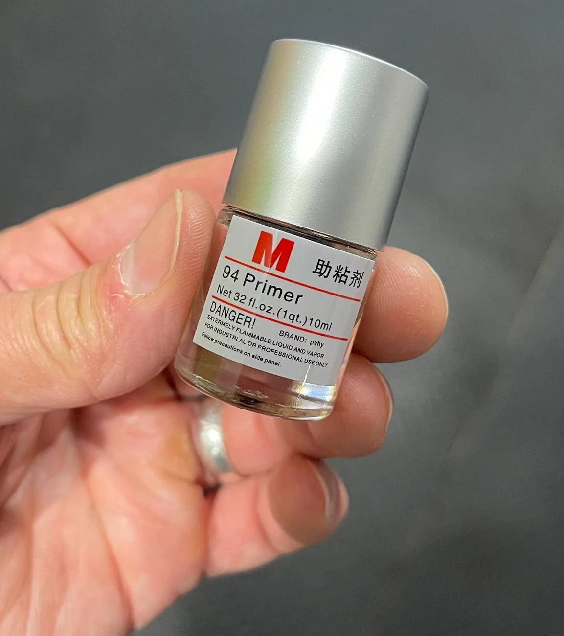

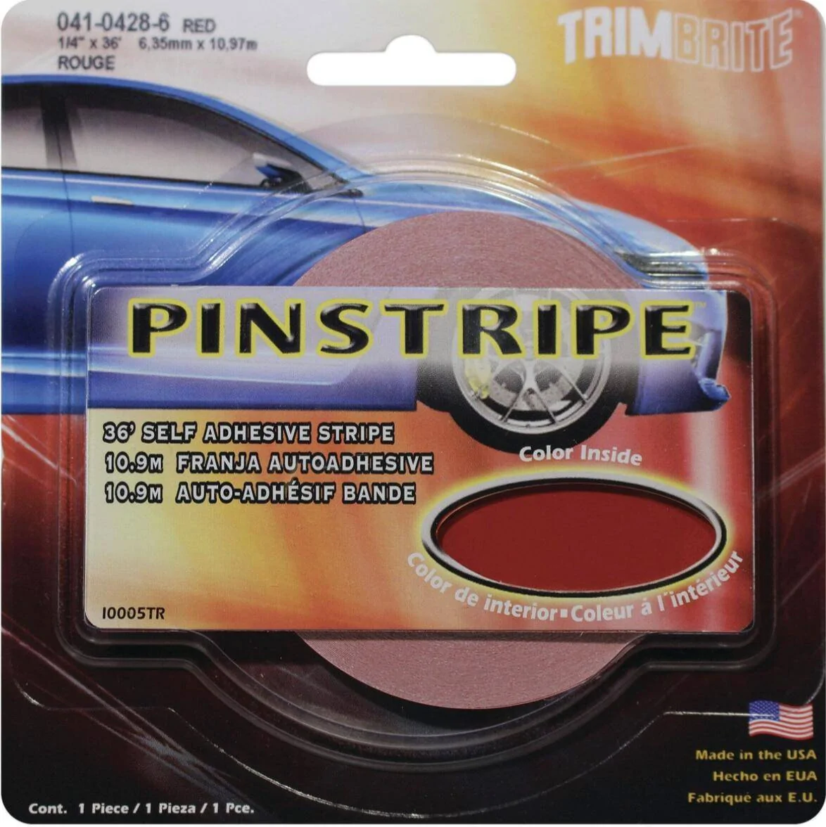

Thanks Glenn!
I went with 1/4" Trimbrite. You can buy it on Amazon.
I strongly recommend you apply 94 Primer first; the stippled surface of the side skirts reduces adhesion. I placed a 12" test stripe and left it on for a couple of weeks to test adhesion and the primer works well. The primer is easy to apply, invisible and doesn't change the appearance of the surface, the the tape is still removable without leaving a residue. Also available on Amazon.
The over-the-top stripes are from the factory, and are 3/8", so a little wider. But because they are viewed from an angle, and the side skirt stripes are viewed straight on, visually they look almost identical.

Redback,
Thanks for the information! That helps a lot. I also am a less-is-more kind of guy and am still up in the air about the door handles. Thanks again! Glenn
