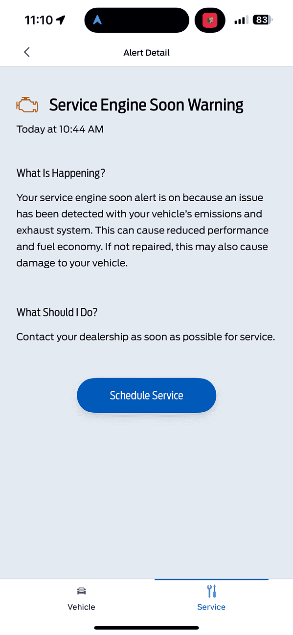

Does anyone know if installing an X pipe would cause a check engine light? I got this recently installed and today is the first day seeing this. Seems to run fine.
S650 Mustang Steeda X-Pipe - Check Engine Light IMG_5312

looks like you have a P0430 code, Catalyst System Efficiency Below Threshold Bank 2. the dealer will end up needing the vehicle for a day or two to do the workshop manual tests and find the cause. could be anything from a loose connector to needing a new catalytic converter. in any case, this has nothing to do with the X pipe and is more likely just bad timing in terms of events
