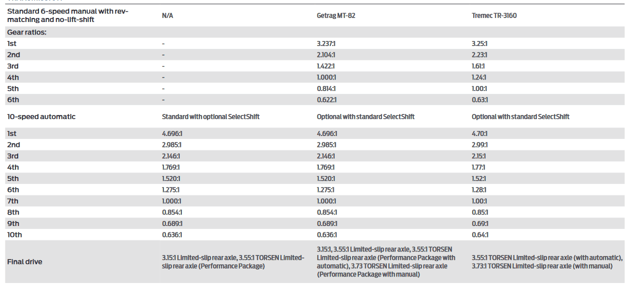

Anyone know if the MT82-D4 has the same internal ratios as the Tremec?

I have an '06 with the TR-3650 Tremec, it is not exactly a smooth shifting transmission, even with a short throw shifter. I occasionally have the 2-3 lockout, but I just put light pressure on the gear shifter, double tap the clutch and it goes right in. I also ordered the DH with the Tremec 6M. I am wondering how much difference there will be between the two other than the extra gear.
I did look at the gearing in both and the TR-3160 seems to have a much closer ratio between 1st and 2nd than the TR-3650, not to mention the higher rear gear:
Gear:2006 GT (TR-3650):Dark Horse (TR-3160):
Rear Axle3.553.73
1st3.383.25
2nd2.002.23
3rd1.321.61
4th1.001.24
5th0.681
6th0.63
Reverse3.382.95
I am really looking forward to rowing the gears on the DH!!

Is this good ?
The Tremec has more aggressive ratios over the Getrag MT-82D4. They are not the same, 1:1 for the D4 is 4th, while it's 5 the for the Tremec in the DH.

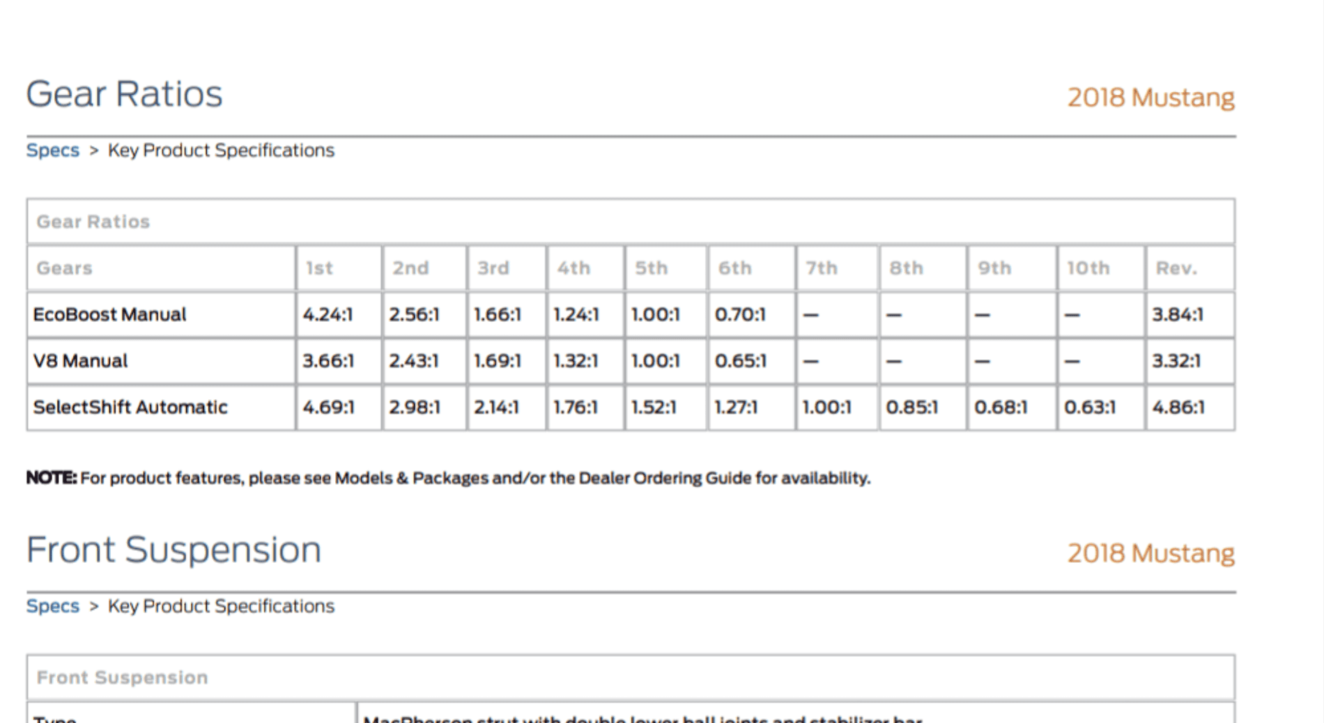

The previous Ecoboost did not get the same transmission as the Coyote, different ratios
